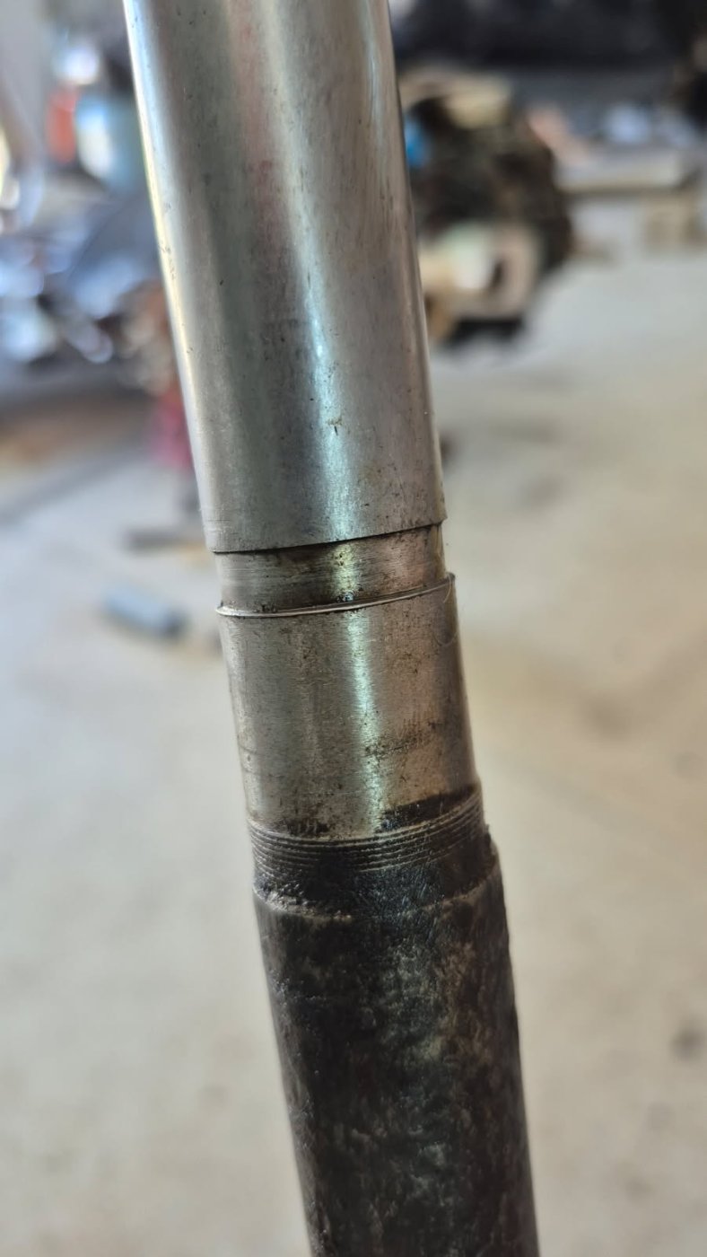

by Daisy Mae
When I got Daisy Mae started the first time I already knew the tranny was worn given 3/8" play in the drum pack, but otherwise appeared decent. The rear end wasn't making any undue noise, so, I opted for a once around the block test drive. Two things noted, delayed clutch engagement, but also a loud sharp clunk seemingly in the tranny, only once or twice, when engaging reverse.
My belief on the clunk was the rear end and immediately tore it down, discovering the DS roller bearing (and pretty much everything else) was so worn the ball bearing pack had grooved the driveshaft from so much side play...the clunk most likely being the pinion and ring gear banging out of mesh in reverse given there was so much slop in the rollers, which Itransmitted up to the tranny.
The clunk was only heard under load on the ground. When the car was on stands, there was no adverse noise nor clunking heard spinning the axle by hand, or, being driven by the engine spinning the free wheels, nor while alternating working all pedal actions. It did not clunk in low or high speed, only reverse, and only under load.
