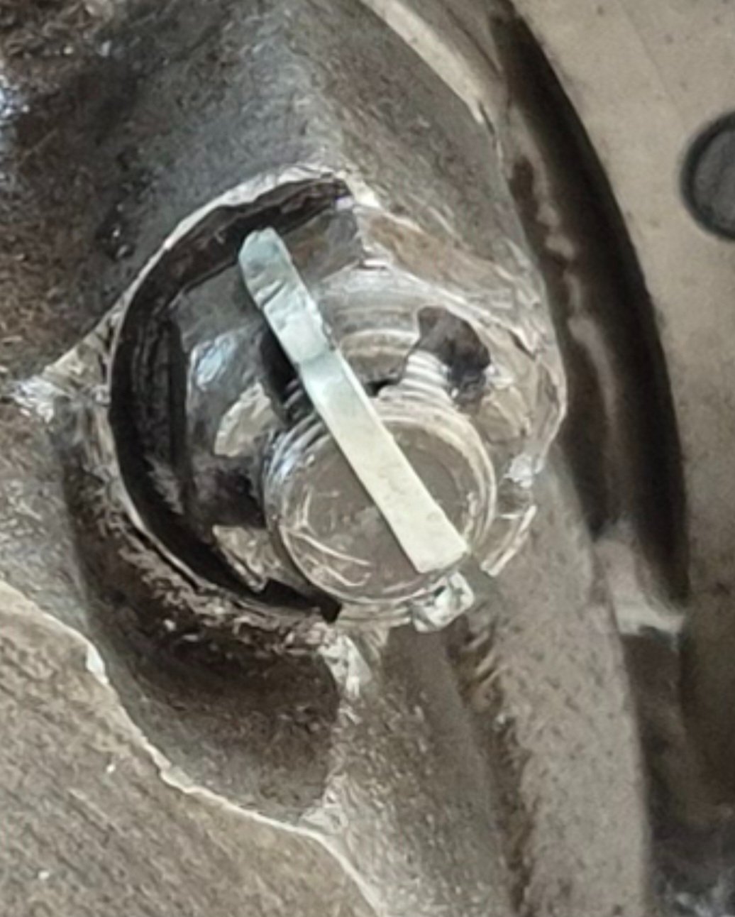

What size cotter pin used in clutch finger adjustment?.... Diameter and length. Thanks in advance

I just use a rule of thumb to use as big a pin as possible to fully occupy the bolt hole, the pin head expanded into the nut slot, then trimmed to length to bend one arm down the side of the nut, the other arm up and across the top of the bolt.

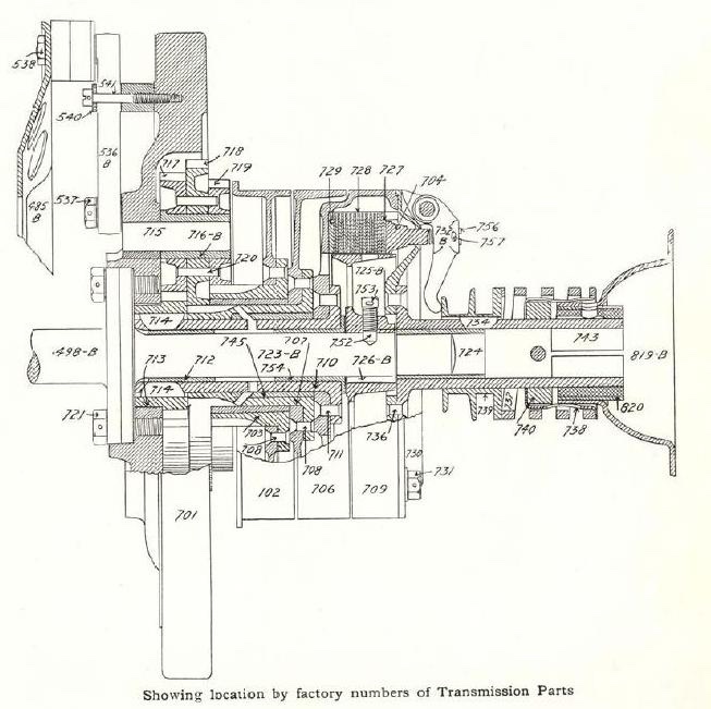

I don't guarantee accuracy, but the Fahnestock book has a
cotter pin list that's mostly correct.

Steve Jelf wrote:
Sun Jul 20, 2025 3:53 pm
:D
Looking @ past posts, I did not see the specific pin for the output plate listed.
