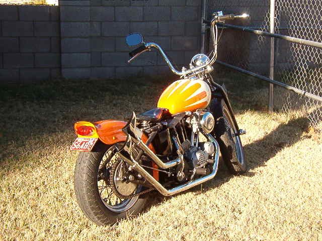

Wilhelm, Harleys vibrate? I never noticed & I rode this one for almost 30 years
If you ride British bikes I would think you would know what vibration is ( just joking ) I'll bet you know what a gudgeon pin is though.
