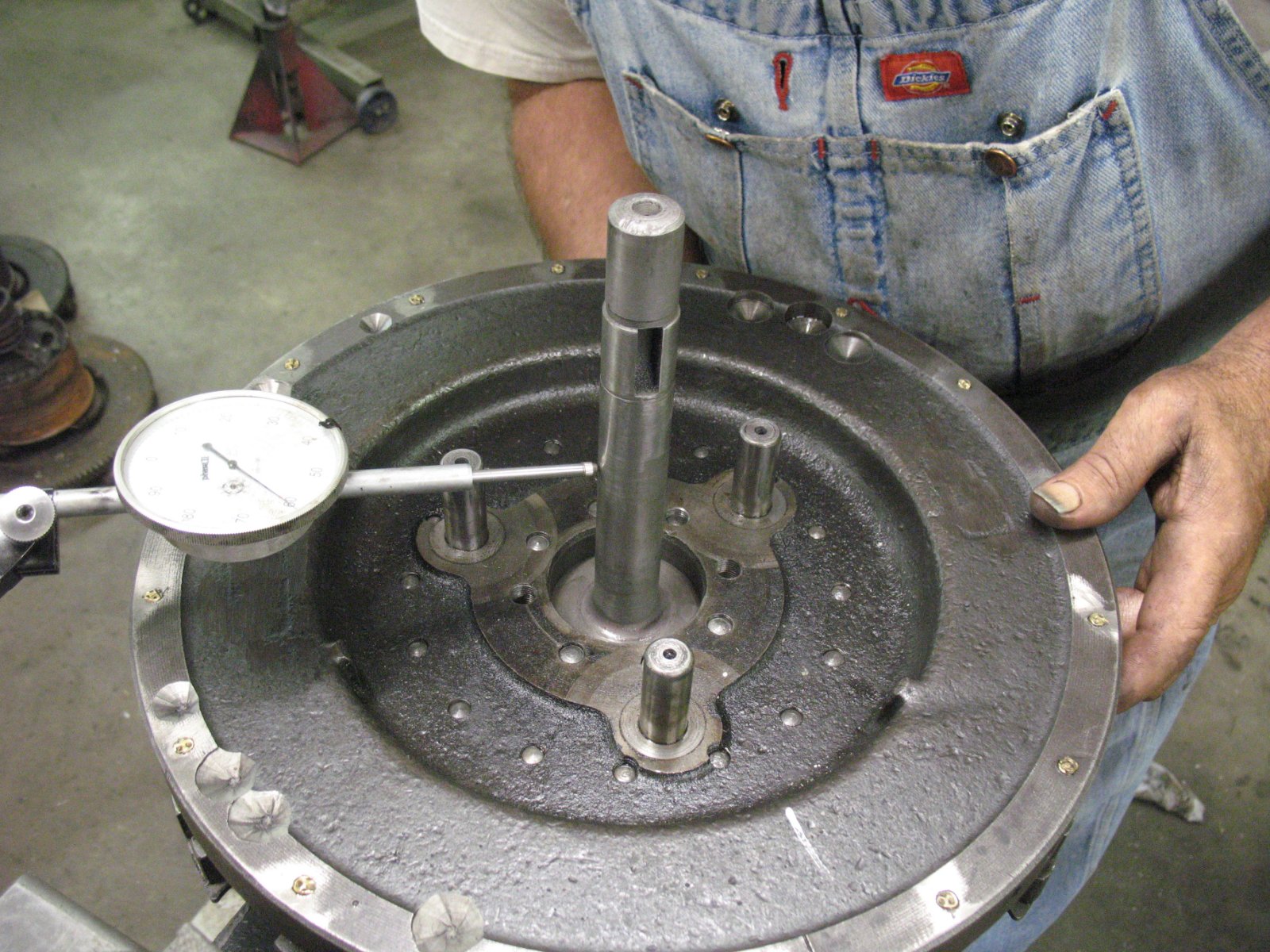

The main shaft was a mighty tight fit, so it went in the lathe for a little shave.
We fought runout for quite a while, but we finally got it under .001".

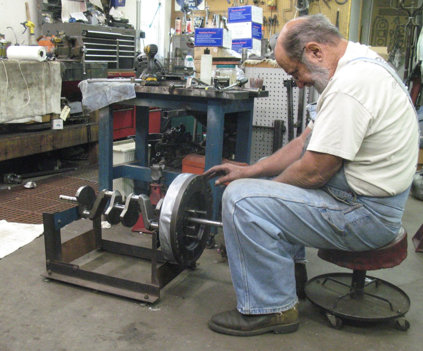

Balancing. The duct tape keeps shavings off the magnets.

Crank that we're grinding for a 1927 Model T.
