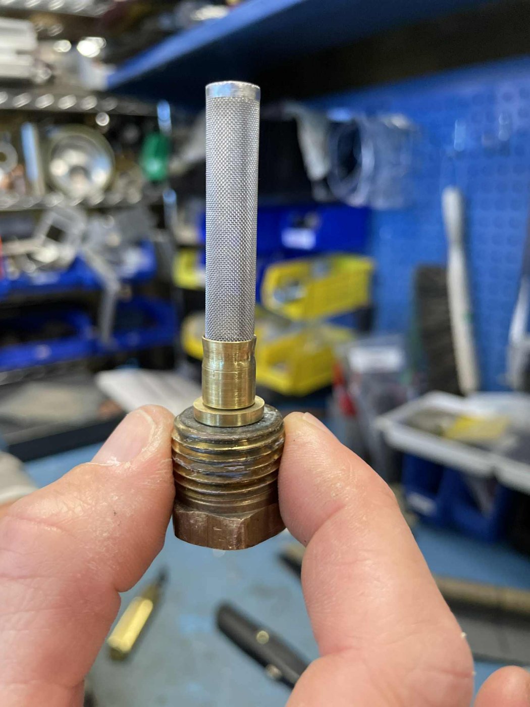

I also use VW fuel filter screens inside the tank. If interested in how I do it leave a comment and I can post explanation as well as photos.

I've come across a filter that looks like what you posted... it would work, but if you ended up with some trash/sediment in the tank there would be no way to drain it out easily right?... at least not something as easy as turning a petcock valve or removing a bowl.
True, it’s a little more effort. Sediment would collect around the neck of the filter screen and just sit at the bottom of the tank. Cleaning it out means draining the tank and removing the fitting. The loctite sealant isn’t permanent so that’s not a huge issue. Fortunately the gas here seems pretty clean and I’ve seen very little for the past two years since the screen has been installed.
