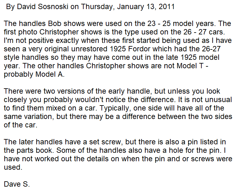

Did some info searching & reading
https://www.mtfca.com/discus/messages/1 ... 1294896310
The shape of the handle body could be different. But current repro's are chrome & may match Model A (button portion)

After examining the photos of the T window riser handles, I have determined they are originals, however, I also noticed that they are the earlier type used prior to 1926, which used a nut on the end of the shaft to secure the handles, so they are no use to me.

1925 & a few years earlier, window riser handles were held in place with a rather large headed slotted screw - totally different than the '26 - '27.
