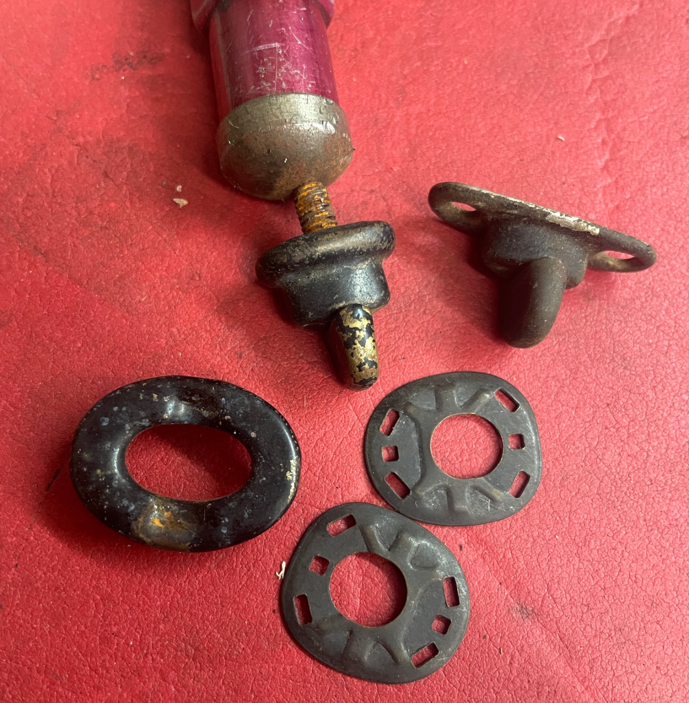

These are some old originals, brass formed , one has metal thread insert that is magnetic.
The others are non-ferrous brass, painted black, the later Lit the Dot backings are raven dull black , the one Common Sense fabric plate is shiny black paint still.

Auto supply catalogs of the period list Common Sense type fastener in all brass, and brass with black enamel paint.
Ford likely used brass for the early cars, and when brass was on the way out, probably switched to the black paint finish.
