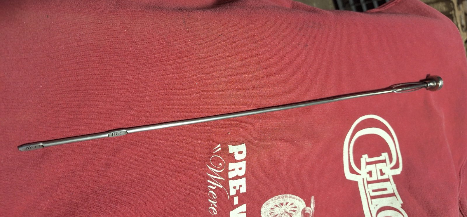

I recently acquired this one. Is this a repo? The dipstick portion is flat

Neither of mine have the lettering on the knob. Both have Akuret cast in the elbow at the pan. Both have round dip rods rather than the flat flexible stuff. The flat dip material would be much easier to make, but if you cant get it.....? There is an alternative.
