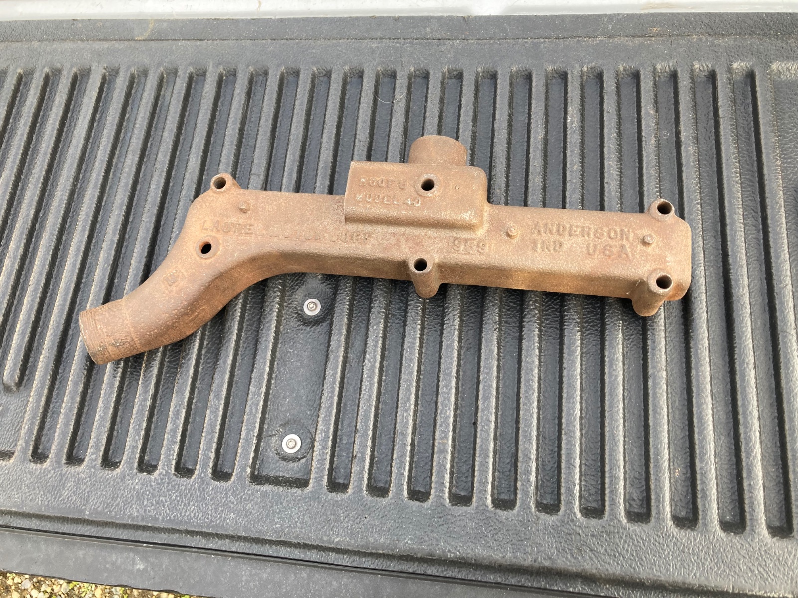

The factory 2 port Roof exhaust manifold looks identical to a Fronty T/S manifold, except the port bolts “lean” at a different angle. Here is a Roof manifold I bought years ago thinking it was a Fronty, then sold it a couple years before finding my own Roof head to match.
The single port Roof heads have vertical bolt pattern
