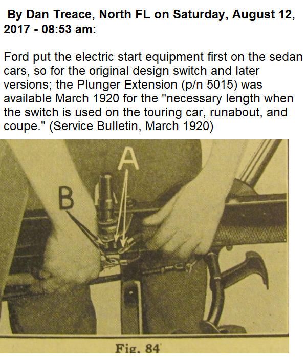

Partial answer: "multiple suppliers"?
https://www.mtfca.com/discus/messages/7 ... 1502458883
https://www.mtfca.com/discus/messages/2 ... 1338731135
Notice in this picture the bracket for mounting the switch to the frame is bent to raise the switch. Some repro's have this bend as well
Plunger shown

So the presumption is the short switch was used on enclosed cars. Open cars have a switch extension.
What about the tall switch?
Looked @ a few T's I have easy access to. 23 touring uses a short switch with the extension.
27 coupe uses the tall switch. With the thick carpet, the switch is well placed with the button just above the carpet top.
27 roadster uses the tall switch also.(no extension) The switch button is a bit lower in position by about 3/8" or so compared to the coupe.
