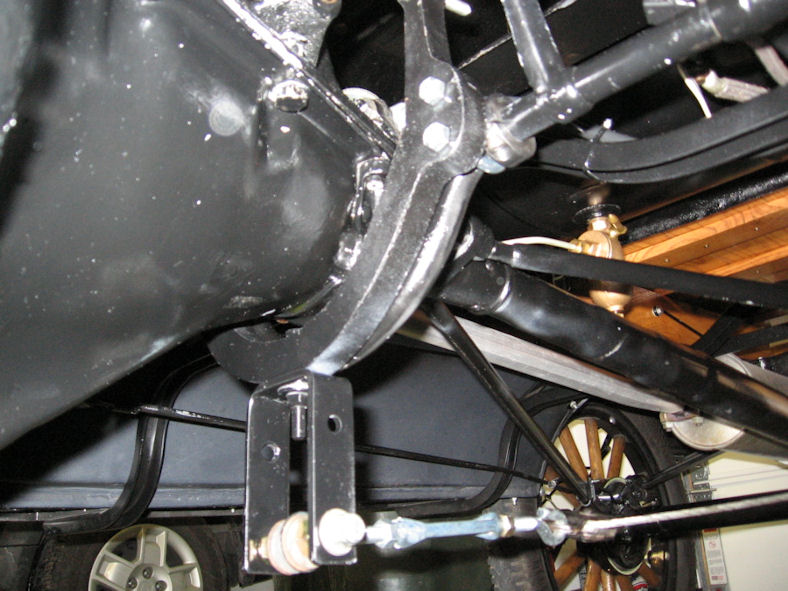

Some photos of other's installs.
100_9403 (500x379).jpg (118.33 KiB) Viewed 658 times

Whether or not thimbles were originally used, failure to use them now would require upping one's life insurance assuming no other stress-free clamping arrangement is provided on the lever on the repro brakes.
FWIW, "improved" AC brakes came with solid steel rods. That ought to suggest something to you (and is covered in another AC post just a few lines down...)
