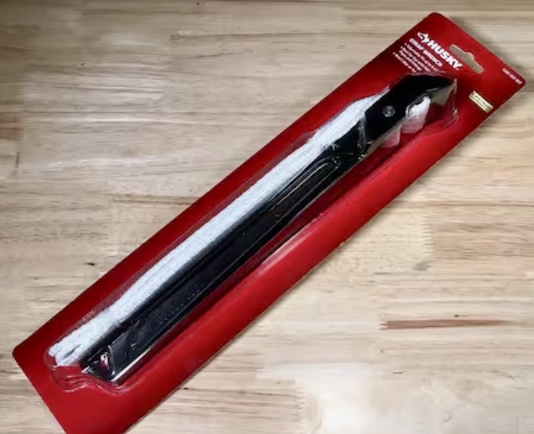

This strap wrench can work too, Home Depot or other big box stores, handle is 14” long, strap 3/4 wide x 34” length, will easily wrap around rim.
