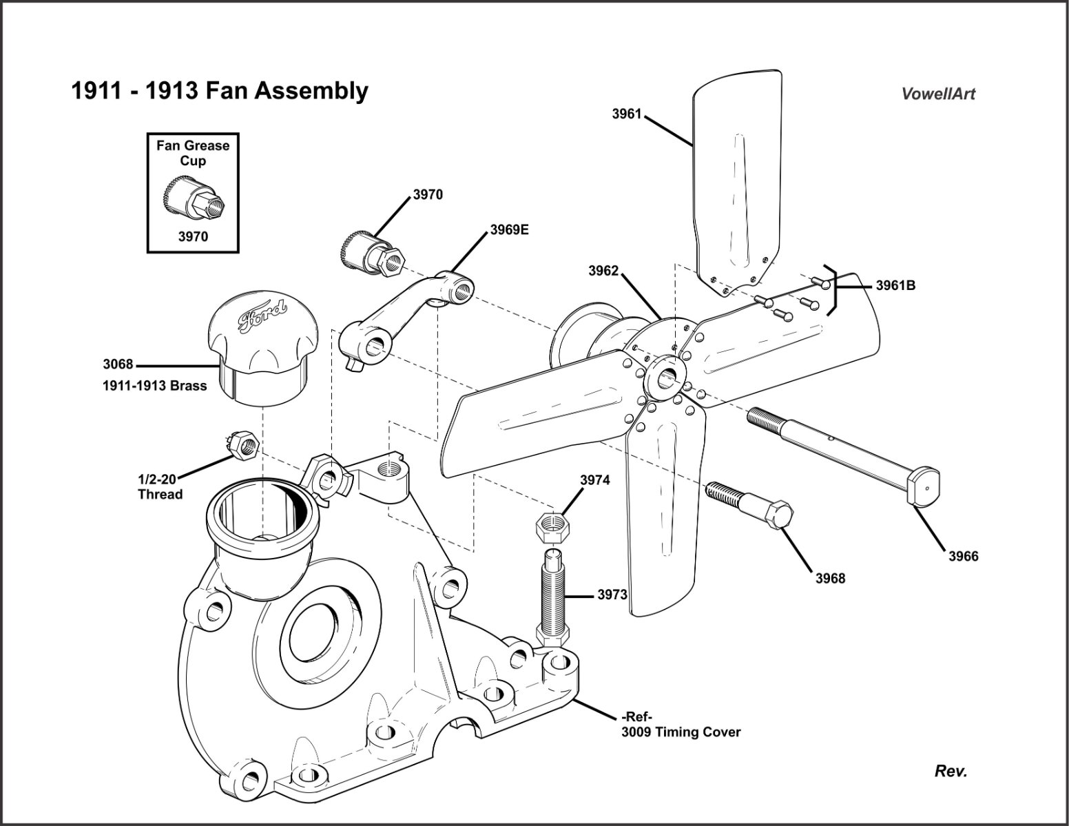

Re: ***1909-1911 Fan Assembly***

Hmmm, ok it is 1909-1910...how about this?
Would like to see a better picture of that timer. Because of the Mid 1911 to Late 1911, oil filler/timer, I might just have to do all the timers, at least on these early cars.
Posted: Sat Jul 13, 2019 6:10 am
by VowellArt
Is this correct for the 1911-1913?
because for a brief period in 1911 (6 weeks actually), they went with an oil filler on the timer itself, which proved to be a really bad idea and went right back to the previous idea with the stud/bolt and nut adjustment. In fact I think Ford had to recall all those with the Oil Filler Timer because the leaked oil everywhere whenever the timer moved (like advanced).
Posted: Sat Jul 13, 2019 6:12 am
by VowellArt
And this one which is the 1911-1911 Oil Filler Timer (which will be a separate assembly).
Posted: Sat Jul 13, 2019 8:33 am
by Walter Higgins

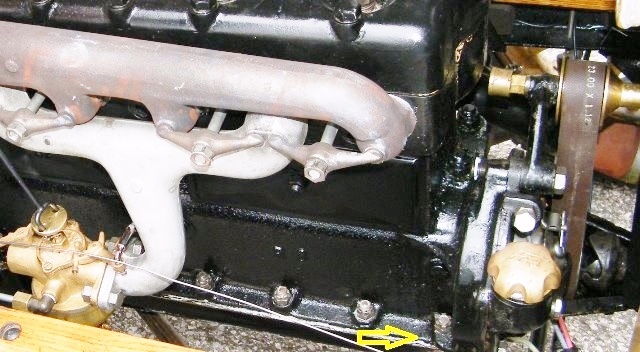

This is my photo from the previous thread. On top is a correct reproduction of the 1909 - 1910 cover that uses the spring and below that is an original 1911 cover that uses a tension bolt. Both of these use two-piece timers.
I don't think either of your two drawings above are correct. After the failed oil fill timer they went to the standard cover with the tension bolt pushing from the side, not the vertical bolt as in 1911. Also, I think the 1912 oil fill timer cover also used a tension bolt from the side.
Just for the record, I think it was decided that the problem with the reproduction cover that uses a pin protruding from the lug with the spring perched on top is that it affects the length and proper positioning of the spring vs. the one that sits down inside the well.
Posted: Sat Jul 13, 2019 9:53 am
by VowellArt
Wish I had seen that second photo before I posted those last two...I kept trying to figure out which way that bolt went from and was told that the bolt had a shoulder on the end that pushed against the fan arm...the one your showing here is directly opposite of what I've been told...I don't think you can get a wrench in the crook of the fan arm to turn the head of that bolt, but I don't know, these are waaay out of my understanding. Have you ever heard that the bolt or stud has a shoulder on it that fits into the crook of the fan arm or that the fan arm has a thick pad on which the shoulder of that bolt or stud pushes against?
Good to know about the 1912 though, I was wondering about that.
Posted: Sun Jul 14, 2019 4:38 am
by VowellArt
Ok, how about this one...I had to change the aspect of the arm, because it sat too low (I think I'll change all of them also, they all seem to be sitting too low and the bottom pin doesn't line up with the gap on the plate). Also made slight changes to the plate itself.
I'm still not sure of the date span though. Let me know so I can get on with the other fun ones...the 2 piece timer and the oil fill timer.
Posted: Sun Jul 14, 2019 2:55 pm
by Walter Higgins
The date span is just 1911. As you know, most things were not an exact model year change and I'm not sure if it went into 1912 a little or if the "1912 oil fill" caught on at the tail end of 1911 a little, but it wasn't used for the 1912 oil fill timer or again after the 1912 oil fill timer so far as I know.

So, even though the fan arm is used clear to 1916, it was not used with the bolt adjustment under the arm past 1911? In 1912, I think is when the steep side bolt was being used, that pushes against the tab on the bottom of the arm (sort of like the later styles) to adjust the tension on the belt. Because as far as I've been able to figure out the oil fill started sometime about late 1911, and lasted only 6 weeks (start in mid October 1911, which is 1912 Model year). They rather quickly found this to be a really bad idea and I think recalled all cars with it and switched to the side adjustment. Because the early 1912 plate I've got pictures of (courtesy of Royce Peterson) shows that side adjustment bolt.
Posted: Sun Jul 14, 2019 5:15 pm
by Walter Higgins
I'm not as well read on 1912 stuff but McCalley's book states for 1911 that the model year runs Nov. 1910 through Dec. 1911 approx and for 1912 the model year runs Jan. 1912 to Sept 1912 approx.
That is correct, the arm continued to be used as it was even though they retained the bump for awhile after moving the tension bolt from vertical to the side. The part worked, so I supposed there was no reason to rework the mold or deplete the inventory. The next style of plate shown below used the same arm. I believe some years later while that same basic style of arm was in use they did eventually delete the bump. That same plate may even be (generally) correct for the oil fill timer as it is also a one-piece timer. Never had one to play with so I can't say for sure.
The two-piece timer was discontinued in 1911 and the plate has to be machined differently to accept a one-piece timer. You cannot install a one-piece timer on a two-piece timer engine without changing to the later style front plate.
