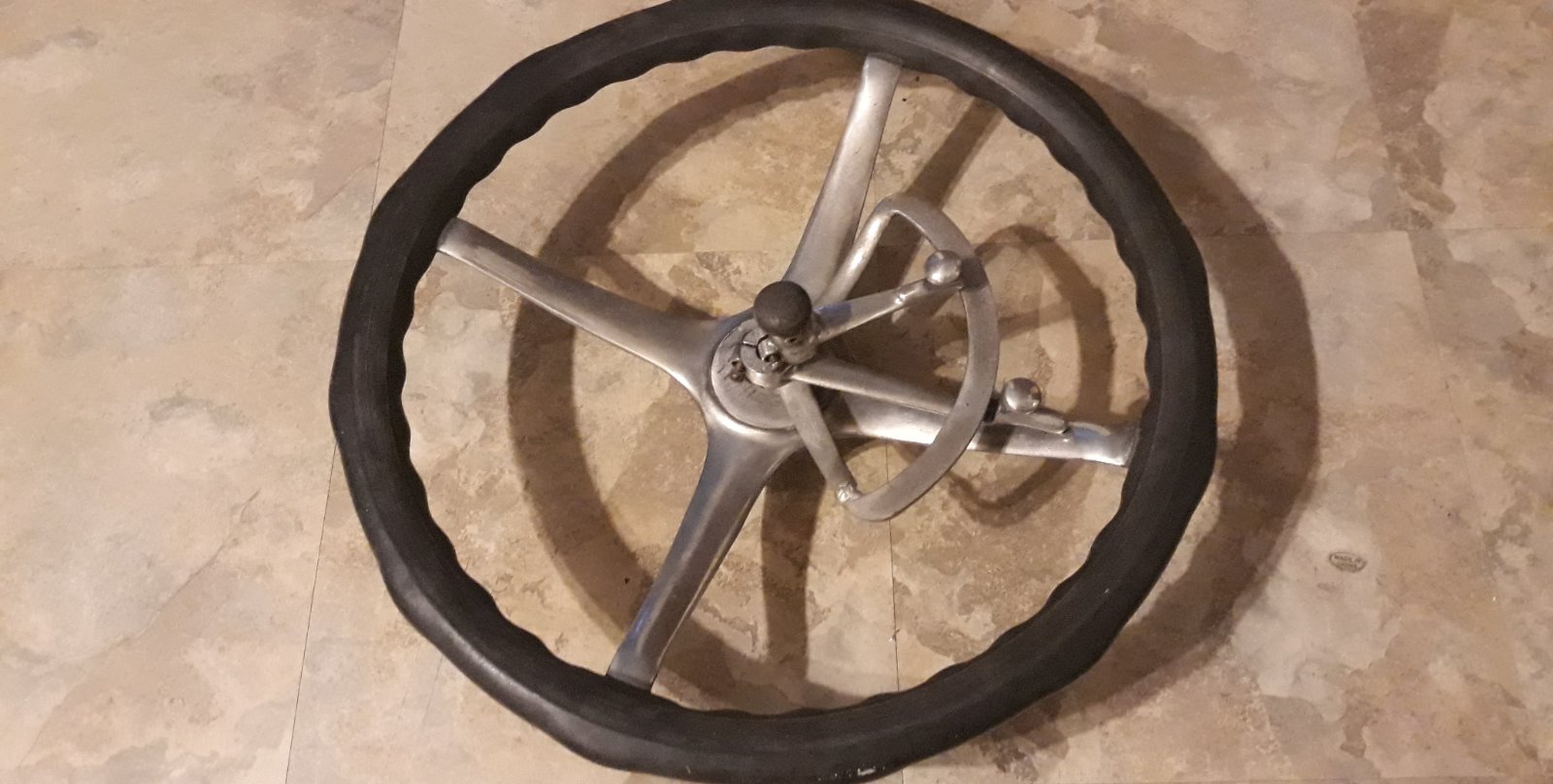

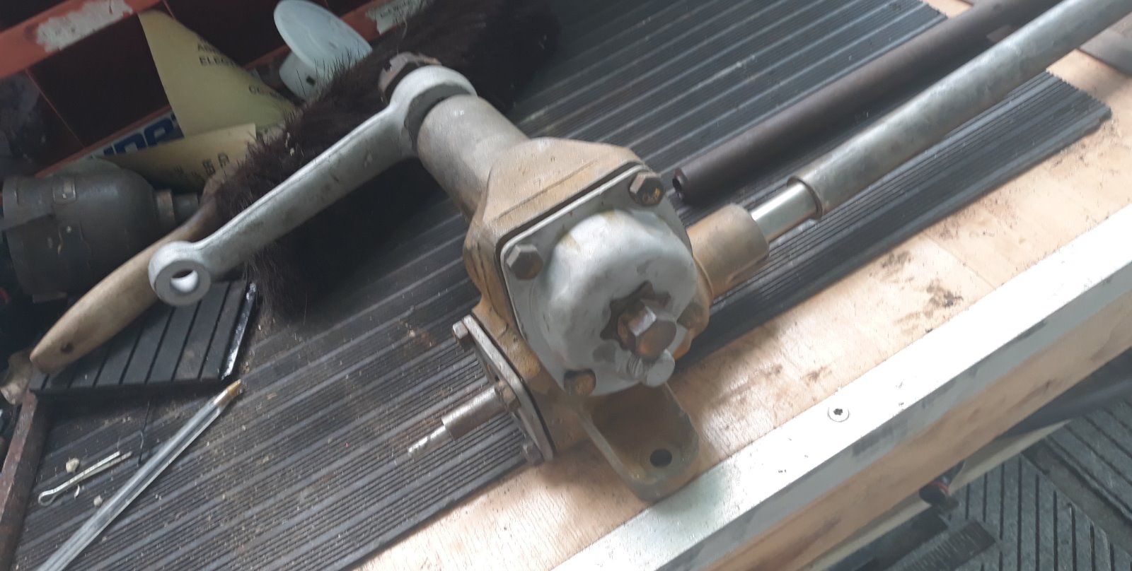

This month though I've started to think more about the steering and start on it. I have an uncommon aluminum wheel and a cool spark/gas, unfortunately the rods go down the middle of the column and thru the gear box requiring a bit of customization.
