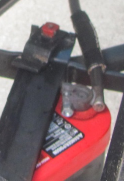

I would be really concerned about the POS battery terminal coming into contact with the battery hold-down.
