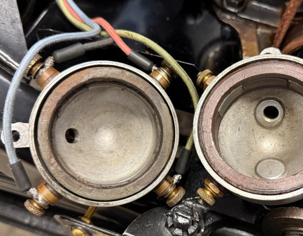

Here’s the mystery commutator in situ, with a well worn stock example on the right for comparison. Both came with the car. The contact points on both have a smaller surface area than your example.

My initial reaction from the photo is that the disk may have been added to raise the wire contacts away from the timer housing because of the amount of solder on the connectors. Wonder what brand that timer is.

I am not an expert on the early cast timer but my gut is telling me it is one of the many replacement ones made over the years.
The Encyclopedia has some good pictures of the Oil Funnel 1912 cast style and I assume it is built like that one but without the funnel
Look at how the insulators, nuts, and other hardware is done for the terminals.
If it were mine I would make new insulators to replace them and add new brass nuts to replace what I assume is their attempt to be a nut.
It might need a quick trim on the inside but does not appear to have much wear.

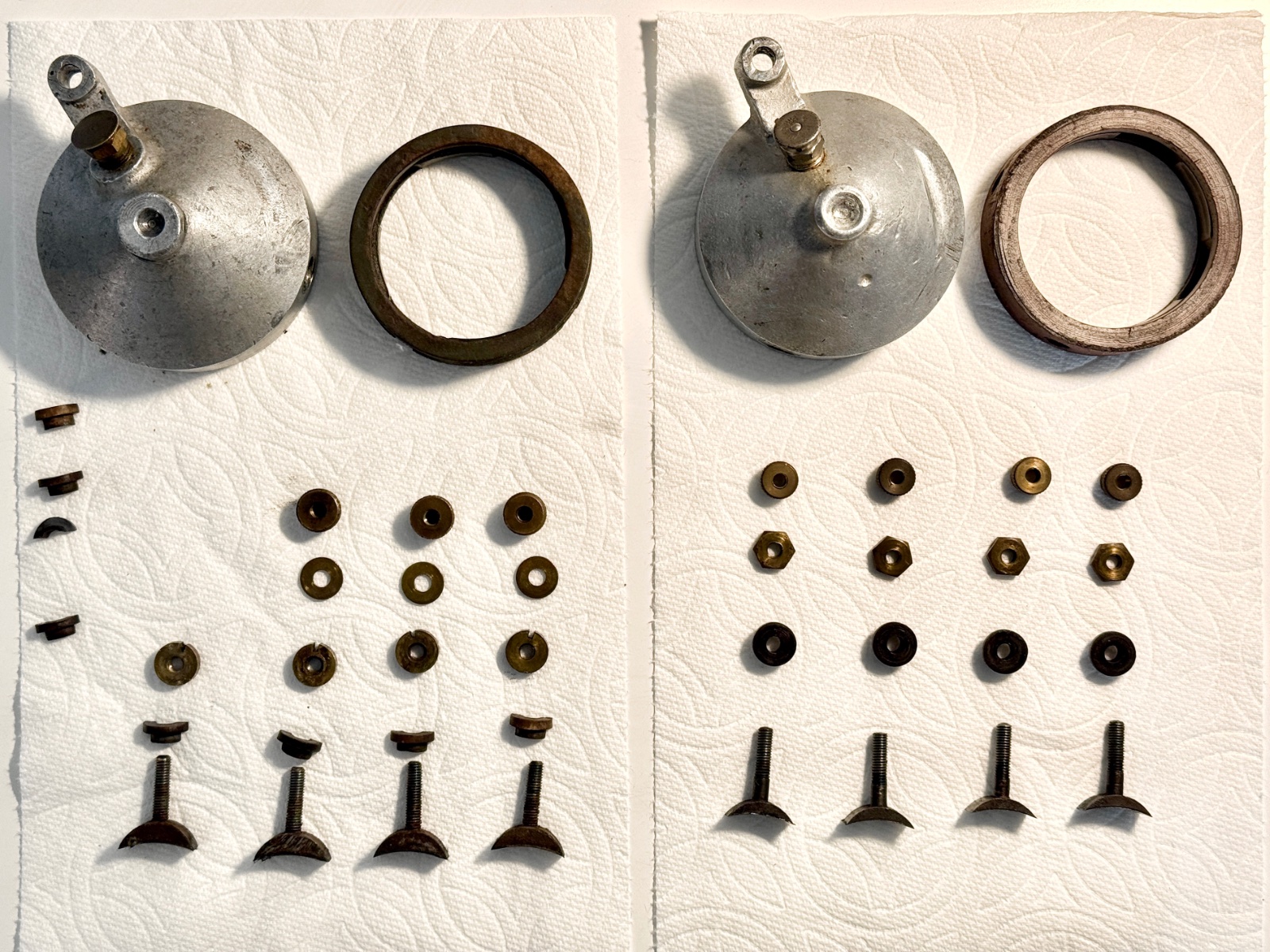

Here is the accessory timer case on the left, compared to a stock (but well worn) Ford timer on the right. The missing parts were on another table when I took the picture.
The accessory timer seems to use wood for its insulation, and all four of the wood grommets have split. I won’t say it’s a cheap construction for failing after 110 years, but the Ford insulators in comparison are in excellent shape. If it were not for the heavy grooved wear I’d be using it.
The car came to a sudden halt while driving, allowing me to coast to the curb. Attempts to restart it did nothing save one threat of a kickback. Normally she stars and runs nicely, so I’m thinking the split insulators led to a short. Has anyone experience with this?

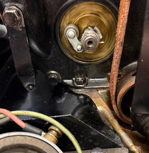

I've never used a roller timer, but I understand how it's supposed to work. Two things stand out in the pictures posted so far.
1
In the timer on the right the contacts protrude from the insulation. Is the protrusion enough to cause roller bounce?
2 So far the roller hasn't been mentioned or shown. What is its condition?

Hi Steve,
The timer on the right in the previous photo is heavily worn, giving the optical effect of the contact points being raised. In reality the “raised” part is just the edge of a roller-sized groove in both contacts and insulating ring. I’ve never used it since I got the car, assuming it was too worn to be functional.
Here’s a photo of the roller. In good shape as far as I can see, and normally the car readily starts on mag with one or two quarter pulls.
The issue is that the engine suddenly running in the midst of a drive. Fortunately it was a residential neighborhood and I was able to coast as much as a Ford can to the curb. I could not restart it or get any response except a slight kickback.
