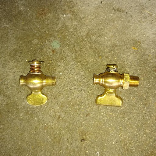

On the left is the OR (original) petcock and on the right is the RE (reproduction) petcock.
The original petcock would turn about 2 1/2 times and the reproduction would only turn about 1 1/2 times. I applied Megaloc thread sealant and installed the petcock. I then used a crescent wrench to tighten it some more. It definitely will not come out and i doubt that it will leak.

by Allan
David, that non original petcock looks to have a slotted head screw to hold the turning piece in place. That is the problem with the early original style petcocks. If that screw comes loose, the petcock can/will open and there goes the fluid. When this happened on my 1912 van, I wired it shut; ugly but effective. I have since jetisoned the original, correct petcock for the more reliable later style.The washer, spring and split pin are reliable mechanical components.
