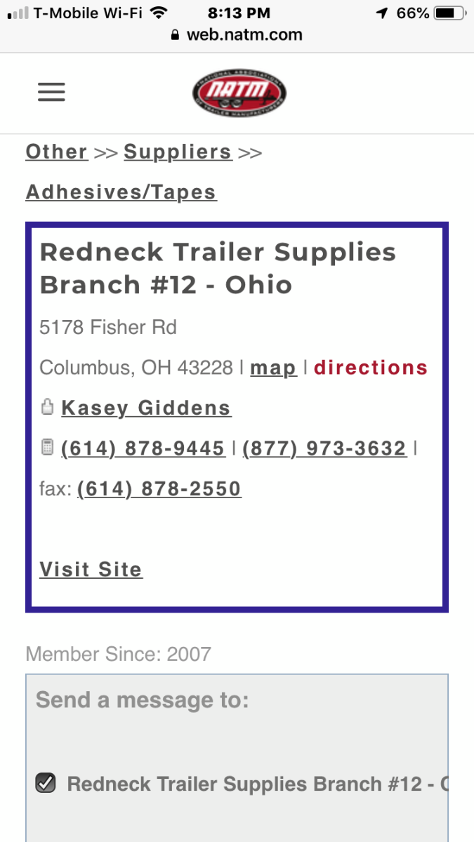

FJ - I'm not too sure that a "Redneck Trailer Supply" store would be very easy to find in the Columbus, Ohio area! :D .....harold
Posted: Mon Jul 22, 2019 8:14 pm
by FreighTer Jim
FJ
Re: Trailer damage?
Posted: Mon Jul 22, 2019 10:00 pm
by Scott_Conger
Harold
I've had business in Newark, and stayed in Columbus. Honestly, without Jim's ad, I'd have said that ANY trailer supply would have been Redneck Trailer Supply. :lol:
Re: Trailer damage?
Posted: Tue Jul 23, 2019 1:52 am
by 2nighthawks
"FJ" & Scott - I'll be darned! In checking Google, there's a Redneck Trailer Supply in Fresno, CA. that serves all the west coast too! Guess that'll teach me, huh? 😀.....harold
