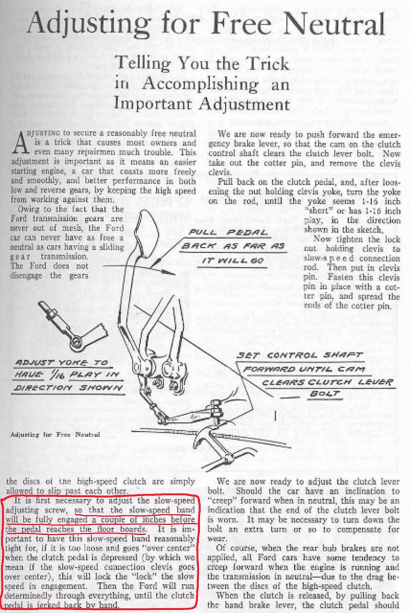

Note the red highlighted area for setting 'Free Neutral"
May be as easy as Duey posted.
A sticking low pedal, having to pull it back with the toe, is many times due to worn linings, or low band adjustment too loose.
That will cause 'over center' and lock the pedal down.
The low pedal should be adjusted with the screw on the hogshead until the lining on the low drum is tight when you depress the pedal to about 2" or so from the floorboard. Don't allow the low pedal adjustment to be too loose, as the band lining won't be able to grip and hold the drum from rotating, and that will wear the linings way too fast.
