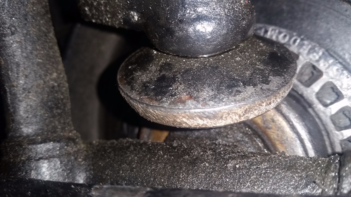

I lost my teethes !!!!
Does anyone has a picture of the 1927 AC speedometer system on the wheel when complete ?
What material is this ?
And a way to retrieve, buy, or re-manufacture such spare part ?
car is a January 1927 Model T Touring with wire wheels option (named "Poupette")

The gear is fiber and is missing it's teeth. The driving gear on the wheel is very worn. I think that if you tried to mate a new driven gear it will wear the teeth very quickly. The piece that fits on the wheel is somewhat common in the US, the fiber gear not so much.

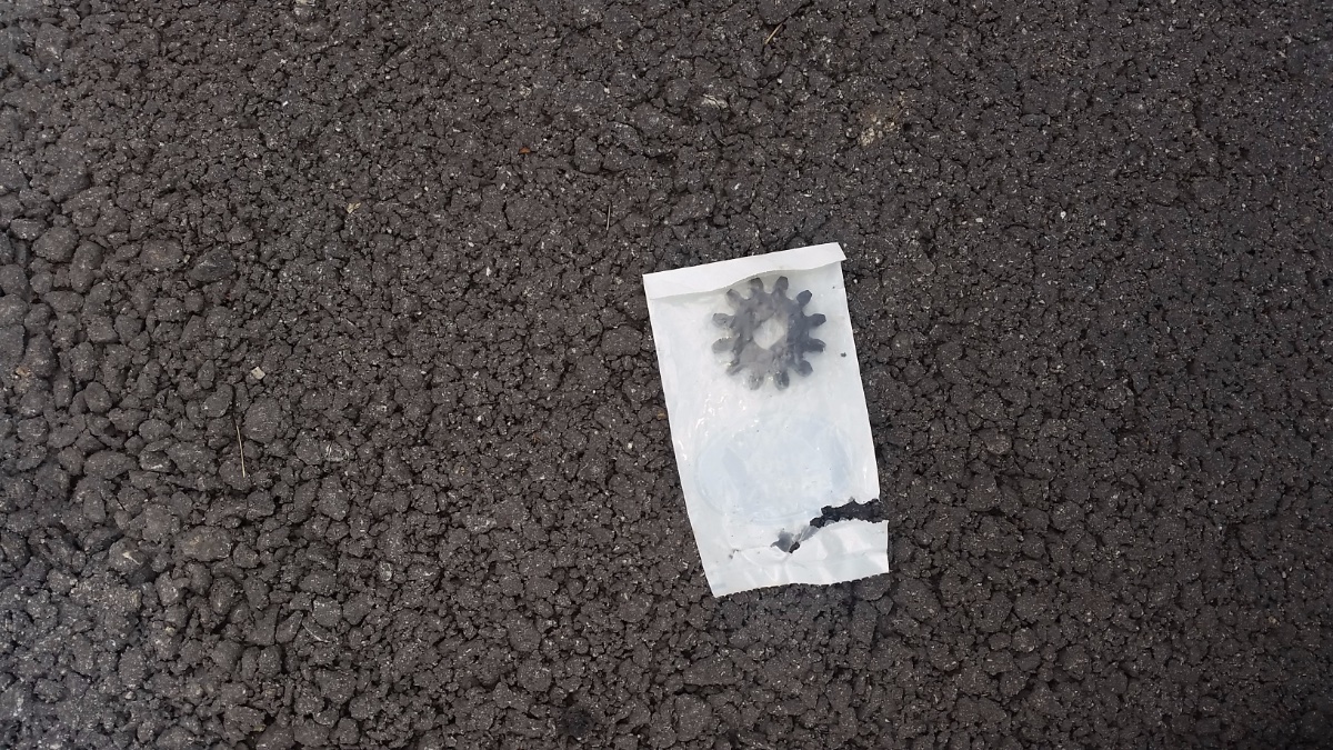

Today I have found that a "Speedo Driven Gear-T-17260-FG" 12 teeth fits well in the wheel gear so I can probably attach it on my "without teeth" fiber driven gear and then have km and km/h instead of miles and mph ... why not ?

Even if you can get the gear shown dished to the proper angle, the teeth count is way off and may not fit the spacing of the holes in the wheel gear. In the event you can get that far, the construction used in making the gear, the teeth may just sheer off. But heck, give it a try. ;)

That 12 tooth gear you have shown in your photo is for a Ford Special speedometer - won't likely work no matter how you modify it.
