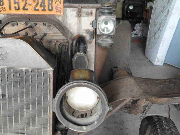

I have an early 13 Touring built in Dec of 1912, probably in Detroit, but sold and/or assembled in Canada. It has American engine serial # 181,4XX, with matching Large data plate, which says Walkersville Ont. on the bottom. Ford did not begin manufacturing in Canada till May of 13, beginning with engine # C-1. I am the 3rd owner from new, and the speedo says 3200+ miles, which looking at the pedals etc, I believe is real. The front fenders have none of the above mentioned beads, and no bill, BUT they do have an extra rectangular rib around the outside edge of all 4 fenders, much the same as a 1910 REO Model R. IF that's a Canadian feature, the only other one is the addition of a Left Hand door on the Fischer built body. This one was sold in Montreal, so its L.H. drive, and even has no holes in the frame rail for the R.H. steering to mount. It also has a few leftover 1912 features, Ford script trans cover, no Made in USA on the head (but it is on the block) that goofy long taillight bracket, and a few other bits. The Rands windshield is equal dimension on top & bottom halves. Otherwise its identical to its American cousins, and still has its factory leather upholstery. I am putting a top kit on it now, the old one did not survive the last tour, and probably was not original, but it was at least 90 years old.. Jeff Beaumont, Gardnerville, NV

Hi Jeff
I'm envious of your '13 Canadian T.
Canadian Fords from I think even pre T had their fenders made in Canada by local shops. A good tinsmith could make them and it avoided the import duty. The extra bead on the outside of the fenders confirms that they are Canadian. The used the extra bead until sometime in mid 14 when it was dropped and the Canadian fenders became essentially the same as the US ones.
