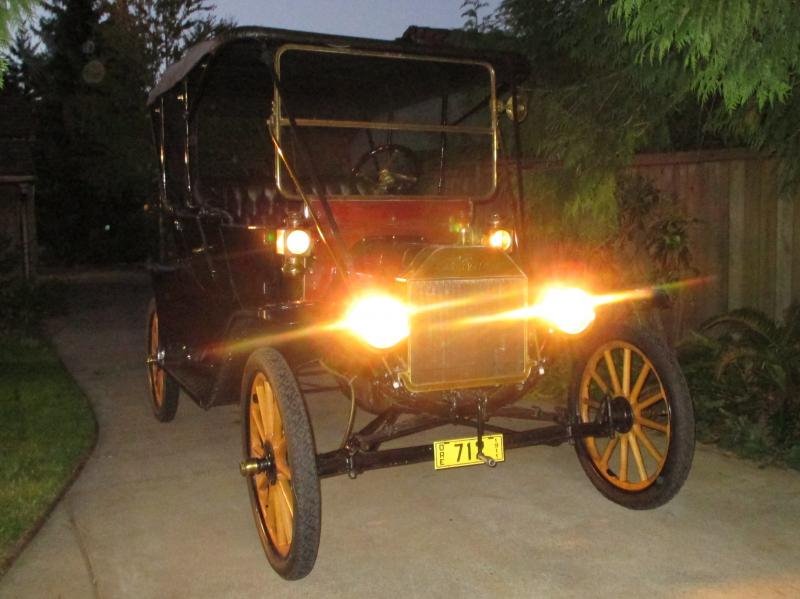

We converted the acetylene lights on our 1913 T to halogen a few years ago. Sockets and bulbs were purchased off of the internet at very reasonable prices. We removed the original burners and made socket holders on the lathe from brass. The socket is 3/4 of an inch in diameter and the socket holders are threaded on the bottom end and screw onto the original burner stand. An original, period runningboard tool box was purchased from a forum member and it is used to hold a 12V deep cycle battery.
