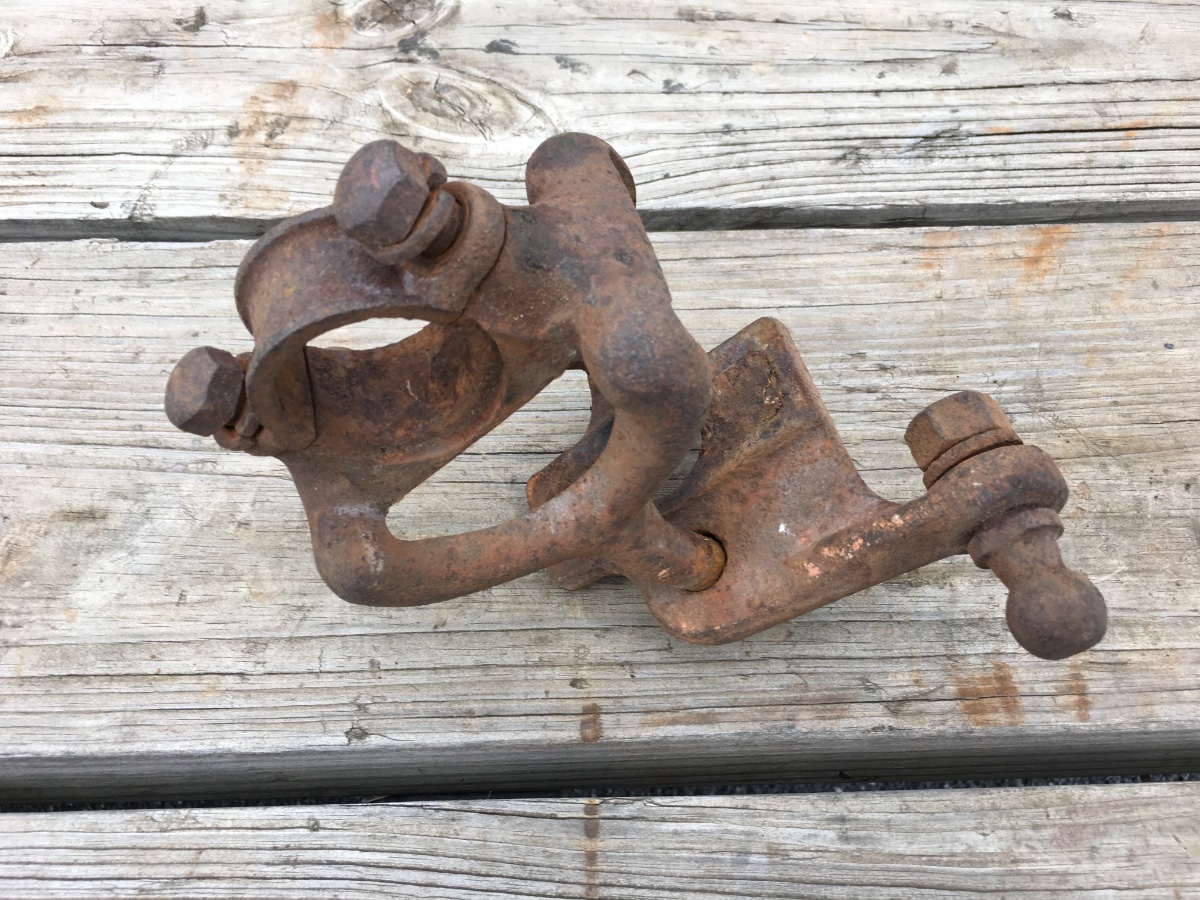

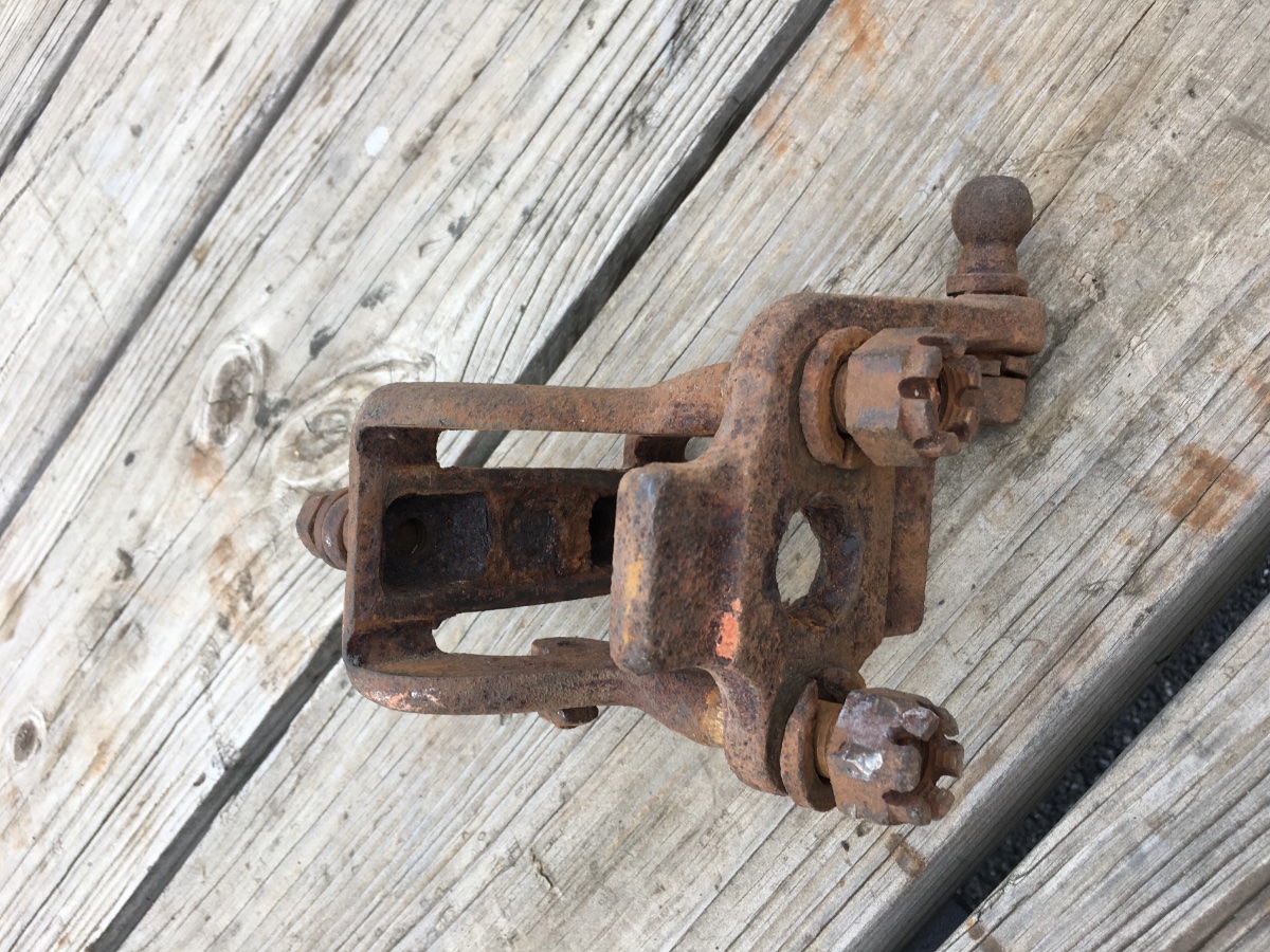

Does anybody have any idea what the purpose of this accessory is?
Re: Front engine mount accessory ?
Posted: Thu Sep 26, 2019 4:37 pm
by kevinf
Possibly a pan hard bar?
Kevin
Posted: Thu Sep 26, 2019 4:42 pm
by RajoRacer
Most likely an accessory shock mount.
Posted: Thu Sep 26, 2019 6:30 pm
by Les Schubert
I agree with Kevin
Posted: Thu Sep 26, 2019 6:40 pm
by Layden Butler
Hartford shock, link went straight down to end of shock arm, body of the shock clamped to the axle over toward the spring perch.
