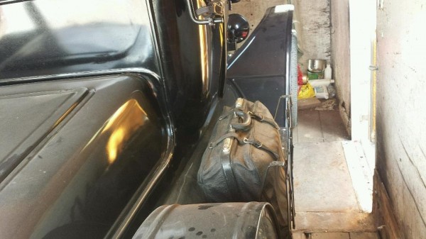

1916 Model T Roadster Value ???

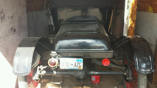

I looked at this car today.  I am wondering what it may be worth.  I was asked to make an offer.  The car was built in the late 70s.  1916 # engine electric start Ruxstell rear end rocky mountain brakes?, McLaren wire wheels.  Owner says runs and drives great.  The car has been parked for several years.  I did not hear it run or drive it.  Just curious what it is worth?
Thanks for any information
Mike
Mike

Really depends on "mechanical" condition of engine/chassis & Ruckstell components - if all is in top condition I'm estimating easy $12 - 15K.
- Posts: 7359
Re: 1916 Model T Roadster Value ???

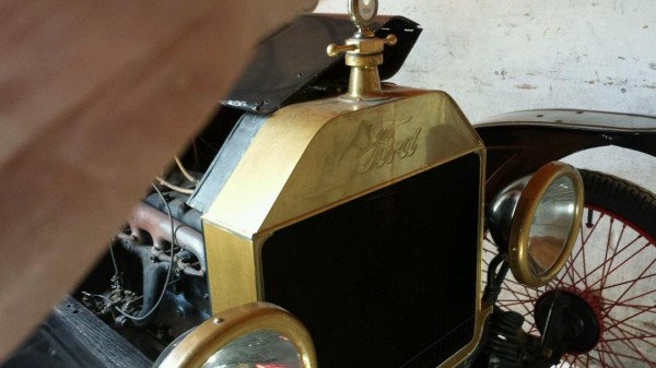

Dressed up with extra brass to look like a 1915. As Steve T says, it depends on the mechanical condition.  I paid $8500 for my 1915 runabout, but it needed lots of fixing.

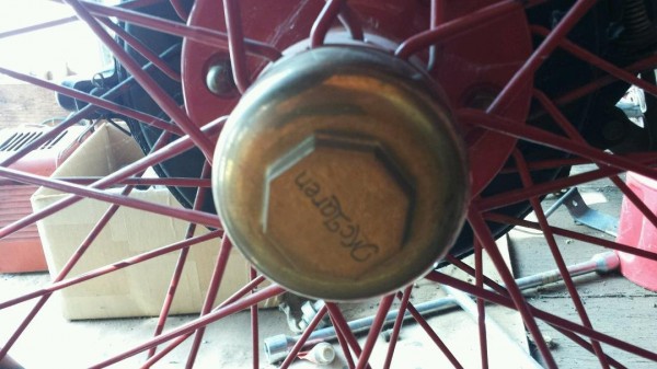

I am new to the craft. I have a 1916 Touring. I thought the wire wheels were much later. Can someone please comment on the variety in 1916?

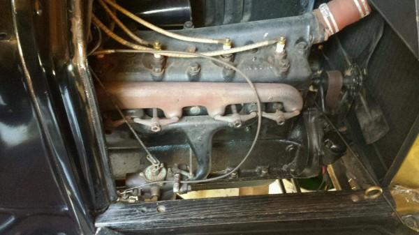

Also, I have the '16 engine on a mount on the garage. The car has a 24 engine in it with a starter. If this car has a '16 engine with a starter how was that acomplished? Steve Jelf or Hank care to comment?

16 engine with a later flywheel and a later starter hogs head  a 6 volt battery that you charge at night when your not using your car.

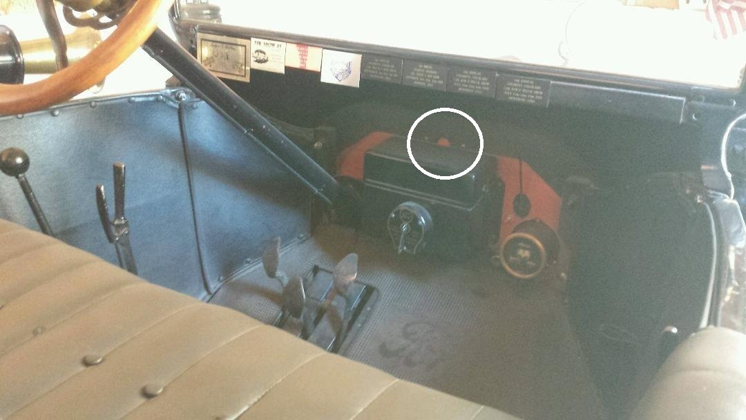

Although that car has a lot going for it such as the aftermarket wire wheels, be aware that the body is 1917 or later as the cowl has a notch in it.
It's possible that the car started life as a 1917 Ford and it has been dressed up to look like a 1915/16. Note that a block with a serial number from August through December 1916 would be in the 1917 model year.
Yes, Ford got around to supplying wire wheels as an option in 1926 and standard in 1927. Before that there were aftermarket wire wheels made for Fords by Buffalo, Dayton, and other companies. Factory supplied wheels for 1915-1916 have rounded wood felloes and were painted body color (black). They are 30 x 3 in front and 30 x 3½ in back.
The first picture on this page shows a 1915-1916 wheel: http://dauntlessgeezer.com/DG113.html

So sad but very common back dated car
So value to me is parts like
Wire wheels 2500
Tires 400
Ruckstel 800
Brass rad 750
And so on add up sellable valued parts and that what maret value is plus conditions of wood body and mechanicals
From what i see in todays market
9500 or less see some pre 15 brass T's hardly pulling 12k or less simular features
Wire wheels 2500
Tires 400
Ruckstel 800
Brass rad 750

This reply is to Eric Johnson.  What are you describing notch in the cowl making it a 1917?
Thanks Mike
						Thanks Mike
- Posts: 3743
- Last Name: Wrenn

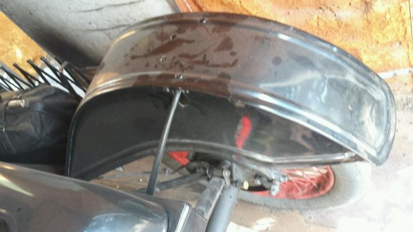

Mike...look in the 2nd pic of the 2nd bunch..right above the coil box. I noticed it too and thought "uh-oh"..another one. I have seen other 15' s for sale with the same. Happens a bit.
