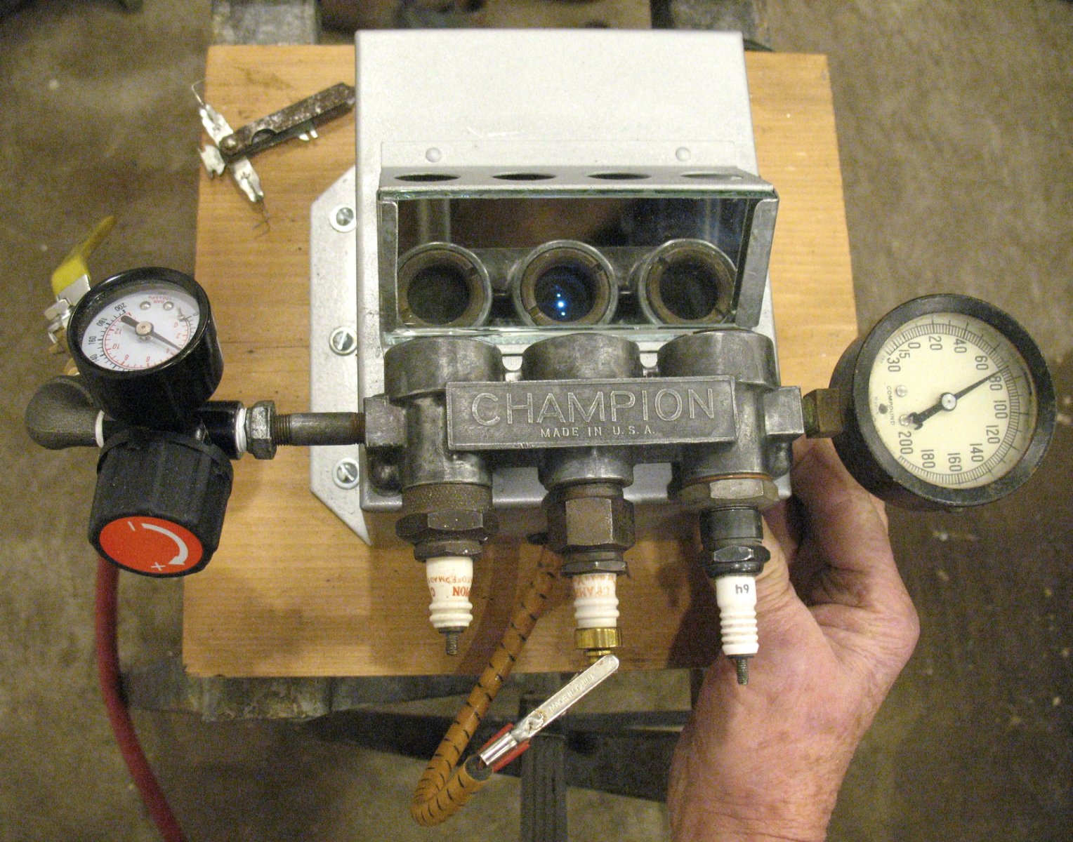

"Dry" compression: 36, 40, 35, 38. That's in quotes because naturally there's a little film of oil from when the car last ran, a few days ago.

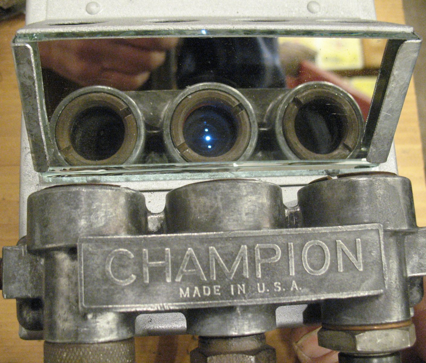

All plugs fire in the tester at 60 psi. I cleaned them and checked the gap again anyway. Plugs are dry. Pulling the crank there's a sudden release at the top like it wants to fire, but no cough in a dozen pulls.

Are you using the same 4 coils in the car to fire the 4 plugs in your pressurized tester? Sound of coil does not guarantee the plug is firing under compression.
If plug and combustion chamber remains dry after choke priming, try priming the cylinders directly and replacing plugs and see if it will fire for a few revolutions at least, if it fires and dies you have eliminated the coils/plugs as the source of the problem.
No, the tester has its own coil.
Screw in the plug, turn on the air, and push the button. Look in the little window to see the spark under pressure.
There are not three sparks. The little ones are just reflections.

I'd rig it up with a 6v battery and some jumpers so you can test the coils with the plugs. Don't get bit! jb
