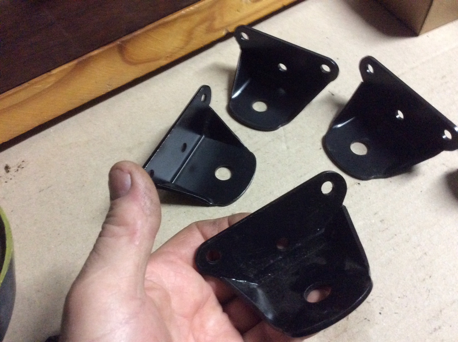

Mounting brackets Depot Hack Body to the frame ?
Posted: Tue Oct 08, 2019 1:07 pm
by Dropacent
Martin, this is how it was originally done, using these mounting brackets. It required 6. If you need a picture of the actual mount, just ask. I think the suppliers offer them. I think I may have enough if you decide that route.

Original type attachment Depot Hack Body to the frame ?
Posted: Tue Oct 08, 2019 5:25 pm
by Dropacent
Martin, using the correct brackets doesn’t raise the height at all, unless you add a rubber spacer of some type. What it does do Is spread the load out further side to side, which is good. I think it’s been determined aftermarket bodies used brackets with elongated slotted holes in the attachment point, to allow for a bit of a variance. If you are building it, it will work pretty well to use the standard body mount bracket that the suppliers sell, or used ones guys have available. Good luck, fun project! One of my pics show all three mounting brackets, attached to a frame rail and main body piece, which is hanging here.
