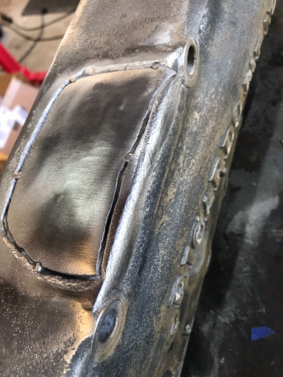

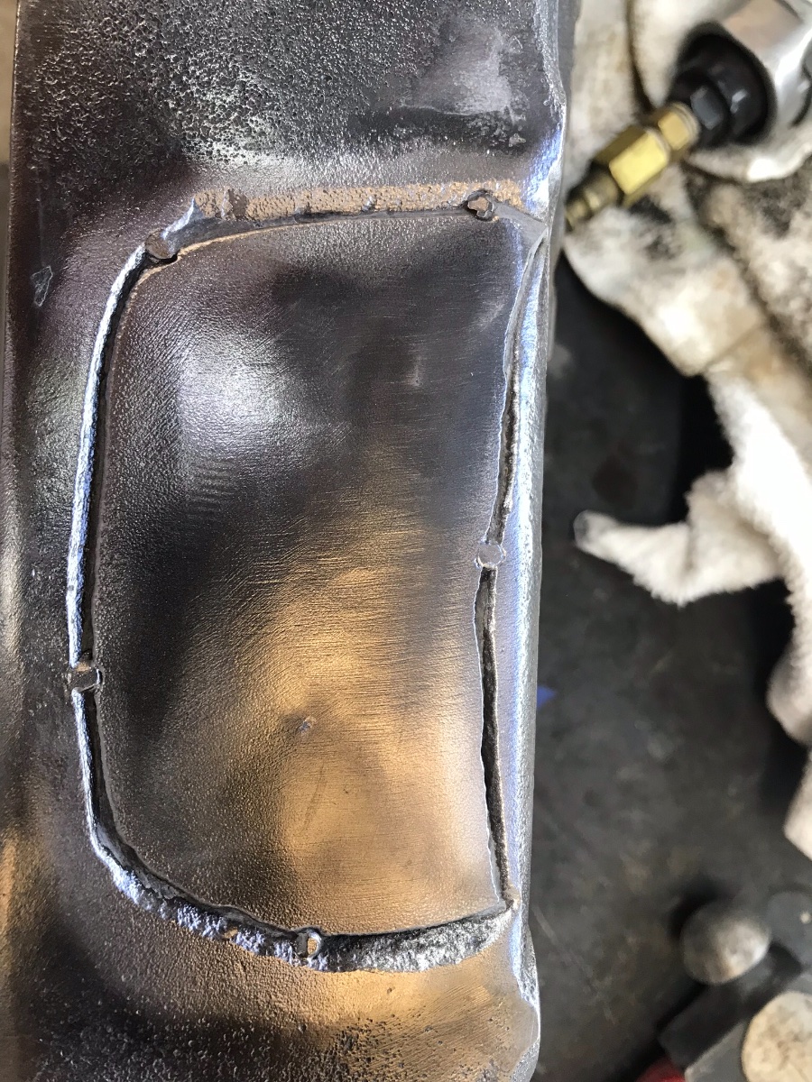

I found a real mag testing unit in all my parts a couple weeks ago and had fun with it today after I got some yellow mag powder in the mail. The flywheel I was going to use had a crack from one of the pins all the way to the center. I have three others that are ok.
All 4 of my brake drums have cracks on every single one of the bolt holes. All 4 of them...
.and then after soaking my Ricardo head in Zepp solvent for 4 days, I uncover this amazing "Fix". There's some work to do for sure... it took some time to uncover it and clean all the epoxy away, but I now know why this head was leaking in a mysterious way...
I see some silver braising to fix this in my future. I found this product that looks interesting
