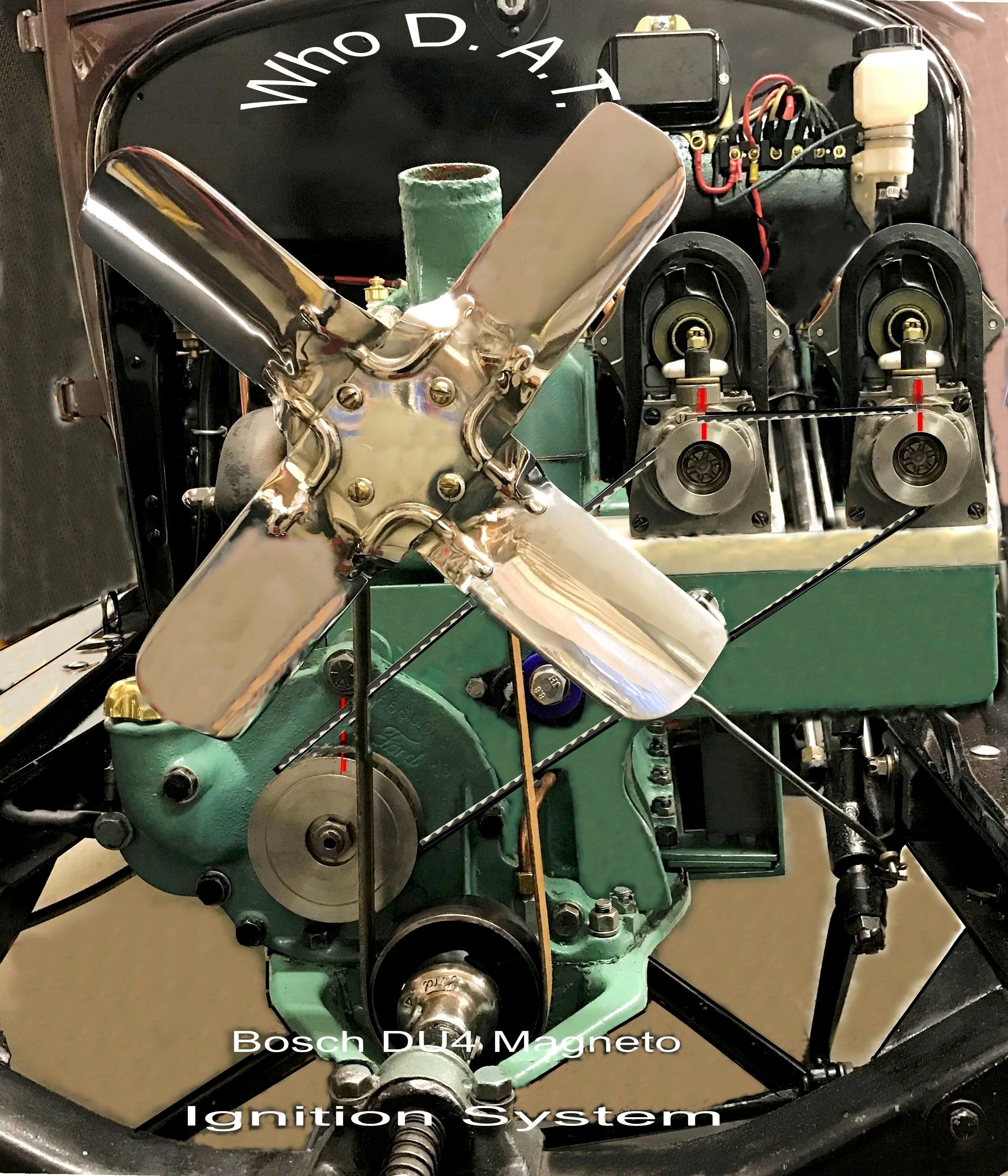

Bosch Magneto 1910 Chain Drive System vs Bosch Magneto Modern Belt Drive System
Around 1910 Bosch built gear and chain drive attachments. Their desire was to add efficiency and reliability for Ford owners. They fitted High Tension Magneto DU4 to the Ford engine. I wanted to do the same to my 1926 Tudor but I had a restriction with keeping my generator on the gear setup side. Therefore, I chose the chain/belt drive system.
My plan was to have the camshaft setup with two pulleys, one on the camshaft and the other on the magneto (with neoprene timing belt between each). I know the pulley system is not authentic or correct for the 1910 chain setup. It’s more modern than most Model T people would like, but it makes a lot of sense to improve the performance of the car. The timing belt has a lots benefits for example very little wear; no noise; no oiling/lubrication to the chain; no chain whipping; the neoprene belt body protection against grime, grease, oil and moisture; and gives a positive slip proof engagement. The Pulley/Belt System has a “PowerGrip-Timing” pulley made of fiberglass; high strength belt; high HP capability; and nylon tooth for long belt life.
The Bosch Magneto has lots of numerous benefits alone, example hotter spark; more power; better gas mileage; a lower throttling of the motor; eliminates complicated wiring (only five wires required, 4 spark plugs, and a kill switch or ground wire); and eliminates frequent filing and adjustment points.
It took me almost two years to design and build belt drive system. I had a lots of help from friends and Model T Members of the Forum. I would like to thank the following people below:

The engine runs great! I still have some remaining work such as the building a control rod for retard/advance; painting; and general cleanup.

Building A Bosch DU4 Magneto Pulley Belt Setup.
Your viewing of “Who D.A.T. Ignition System” article is amazing. So, I thought of continuing articles by showing the details of building the pulley belt setup; (researches, documents, photos, videos, costs, contacts) from the beginning of the project to the end with the running of the engine. If you chose to build the pulley belt setup maybe I can save you time, and money. The question I can answer today. Yes, I can build this setup faster, cheaper, and with less mistakes. Cost was important and it forced to me do a lot more of the work machining, but I was committed to compete the task because of my investment at each stage of the project.
Let’s start off with discussing the elephant in the room. The cost of the items:
1) Bought Bosch DU4 magneto on EBAY $155.00.
2) Rebuilt Bosch DU4 magneto (Counter Clockwise) for $563.68
3) Purchased 10mm chain wheel Tensioner $11.99
4) Purchased SS base tensioner $26.00
5) Purchased 14 tooth gear pulley sprocket $34.14
6) Purchased 28 tooth gear pulley sprocket $71.48
7) Purchased timing belt $23.40
8) Purchased stainless round tube for camshaft $15.60
9) Purchased natural nylon cast sheet shimming bracket $52.86
10) Purchased 7’ foot spark plug wire and brass connector $18.00
11) Purchased Brass TINTON LIFE Universal Bathroom adj. shower head wall mount holder base org spark plug $16.97
12) Optional purchase pencil tension tester $23.22
13) General bolts, nuts, drills, skill saw blades (guess) $30.00
14) Salvage yard purchase street aluminum light fixture $50.00
After, spending better than $1,092 dollar I still didn’t have a turn-key working setup. Each task requires doing my homework. One of the main problems I experienced was that no one had built a setup on a Model T Ford using a pulley sprocket belt system. So, the only guide/design was using the 1910 Bosch chain drive setup.
The tools needed to proceed are a socket set (std/metric), sander wheel, files, band saw, saw all, jig saw, drills, drill press, taps, drill motor, air tool cutting fiber wheel. Tools I didn’t have: metal lay, and welder,
Please feel free at any time to ask questions of any kind? Some may not want to continue with following this article because we will sometimes be getting into the weeds and it might be more than you want in the discovery process. I WILL TRY TO KEEP MY DISCUSSION AS BRIEF AS POOSSIBLE TO NOT LOSE YOUR INTEREST. Let me assure you that I’m a layman, who only wants to learn more about my Model T Ford. I’m learning from you as much as I can.
One of my goals was to keep the setup looking simple, and neat.
The ace I had was mentor Steve Tomaso (RajoRacer) who restores Model T professionally and loves the hobby. He loaned me a camshaft core while I was working on this project. Also answered a lots of my questions as needed.
The topics being covered are:
1) Research all aspects of Project. Note: in all cases I tried getting lots information with more than one person as source, books, documentation from the Model T Forum about the subject Bosch Magneto.
2) Purchase of Bosch DU4 Magneto repair and setup documentation.
3) The do/don’t using/and the servicing a magneto.
4) The camshaft research size outside dia., length shaft, location of the camshaft pin, length of threads.
5) Building of the bracket based on my research and using Bosch chain drive setup as a guide.
6) Research and modification of the pulleys, belt, and tensioner using the original chain drive setup.
7) Machining and welding the pulley sprocket and drilling the pin location hole camshaft.
8) Purchase of wiring for engine and building wire collector keeping it engine looking neat.
9) Final looking at design of the retard and advance of Bosch Magneto.

On Oct 16, 2020 5:24 pm a posting in the Forum discussion:
By Harry Lillo “Options for spark ignition for twin plug heads”
After seeing the posting in the MFTCA forum, I realized that two Bosch DU4 Magnetos can be used for twin spark plugs per cylinder for an OHV or a flathead on a Model T engine. This can be accomplished by using the Bosch DU4 Pulley Belt setup that I created in the book “Who D.A.T. Ignition System”. The gearing keeps the two Bosch DU4 magnetos synchronized for manual timing. Both magnetos will produce the same hot tension spark with no performance lost to the motor. There are many advantages such as low cost of purchasing a Bosch DU4, maintenance, and it is just a clean setup with no down sides. Attached is a photo of how-to setup the ignition system.
Re: Who D.A.T. Ignition System
Posted: Thu Nov 05, 2020 3:21 pm
by Susanne
Plus it's a lot easier (and cheaper) to find a pair of DU4's than either a dual dizzy or dual spark mag. Great idea!
Having had to change a few timing belts because they failed to sheared "nubbins" on modern iron, I'm curious if adding a second ension idler below the first (left in the photo, right in car direction) mag to get more of a "wrap" on the mag pulley? It looks like it's only engaging a few cogs on the belt, not an awful lot of contact.
Anyway, it's got me thinking for my pre-generator motor... fun stuff!

For those who have purchased my book, on Amazon, I have built a pulley belt setup with the 1910 Bosch Bracket.
See the photo. Also, you can contact me for additional photos.
Posted: Sun Jan 10, 2021 9:29 pm
by Norman Kling
It would be interesting to see how this fits with the fan and fan belt in place.
Posted: Mon Jan 11, 2021 5:58 pm
by dmdeaton
Norman
Pics above in the thread show the finished product with all belts in place. It was using his homemade shelf, but belt placement is about the same
Posted: Sun Jan 17, 2021 5:42 pm
by sportbingo
Danny
Your correct, the 1910 Bosch Bracket setup has the pulley belts alignment in the same location. See the photo.
