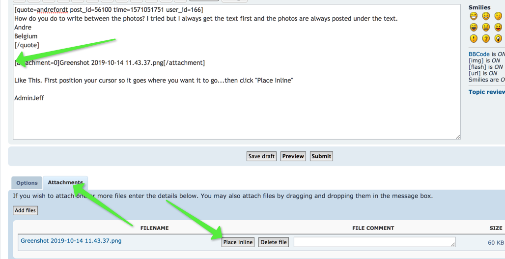

andrefordt wrote:
Mon Oct 14, 2019 7:15 am
How do you do to write between the photos? I tried but I always get the text first and the photos are always posted under the text.
Andre
Belgium
Like This. First position your cursor so it goes where you want it to go...then click "Place Inline"
