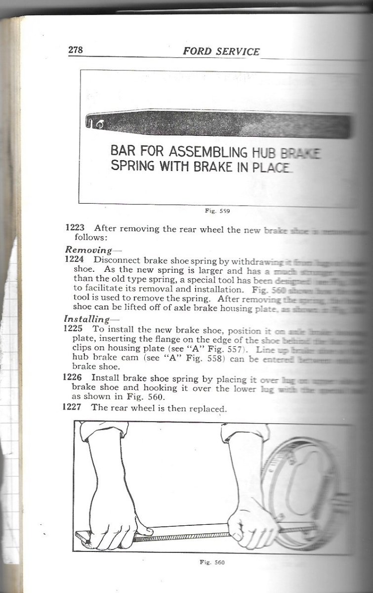

Leverage ;)
Ford shows using a bar like tool, so both hands for the work.
But just did that this last week, my trick is a handy pair of good Vise Grips, snapped around the lower spring shank, and then placing a bar on top of the widest part of the horizontal locked pliers handles, used a socket extension bar, 8".
That gave grip with both hands to push down hard and stretch the spring so the hook fitted into the band lug. Keep face out the the way when looking to hook that spring in case something flies apart!

Thanks for the tips gents. I finally got the job done using vise grips and a bar for leverage. :P
