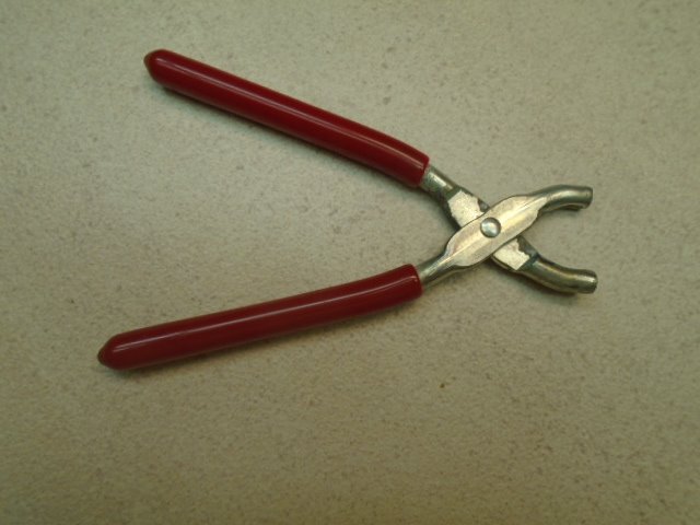

Mark, are you asking about hog ring pliers?
Bill

To crimp the bead in the upholstery cushion into the channel of the seat spring, I like to use this tool:
I got mine at Harbor freight.

No, the original type installation is not with hog rings it is with a metal channel around the base of the seat frame. The upholstery is pushed into the groove and then the surrounding channel is crimped. I did look at the sheet metal seam tool at Harbor Freight but it seems to wide to fit. So people have used it?

The tool that kwtownsend shows on his post worked good for me. It’s a sheet metal crimping tool I believe. Anything that will crimp the metal channel will work. Just do it evenly and it will come out great. I went along the seat and crimped it about 3-4 inches apart to evenly get the seat material in place. Then I went around again and crimped it all the way around.
Just make sure you have the seat spring compressed enough when you do it.
