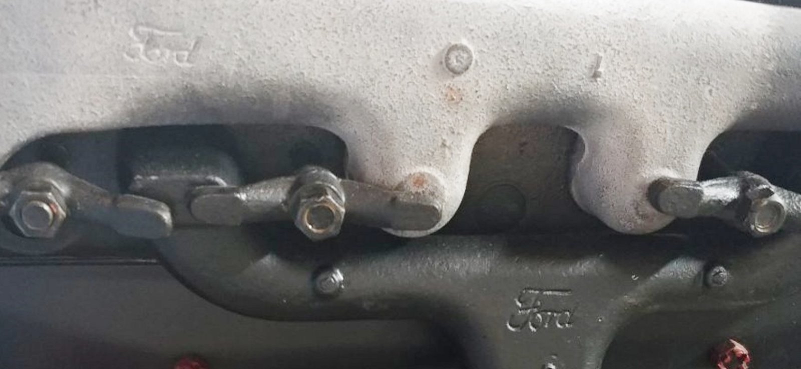

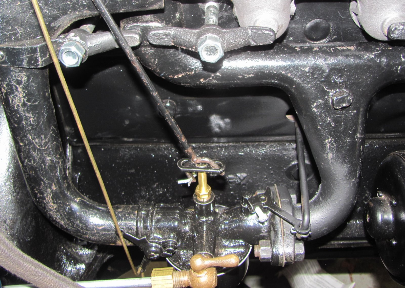

by DanTreace
Steve
What type of manifold gaskets are used? Those newer all copper crush ones can make the manifold stand off the block somewhat.
Close up of your set-up shows the clamps a bit canted and alignment off some. Clamps on the exhaust manifold body instead of the flat spot on the manifold.
You may be able to get that intake to seat more flush with adjustment of gaskets and clamps?
Your manifolds from your photo.
Typical alignment of clamps, clamp tips even on each manifold flat spot.
Re: Stromberg OF install problem.
Posted: Sun Jan 27, 2019 1:27 pm
by Steve Bender
Dan,
I did use the copper gaskets. I lined up the clamps and tighten them and just got enough room for it to miss the frame.
Thanks to all for advice.
