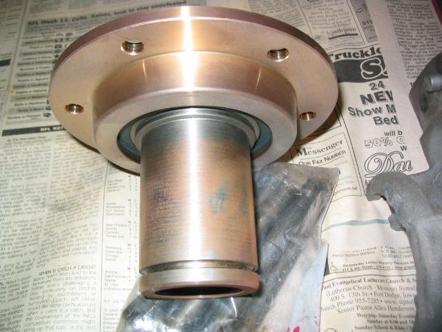

Looking to buy a set of safety hubs for a large drum axle with wire wheels. Looking through the vendors offerings I've notice some differences between designs. I'm soliciting people to share their experiences and opinions, pros and cons on those that they may be familiar with.
Stoltz .jpg (37.95 KiB) Viewed 5337 times
This is the Stoltz (Model T Ranch), 2 "O" rings and a needle roller bearing (is this necessary and a good application for this type of bearing) and a wide groove to I assume allow the "stub" to move both radially and length wise? It appears from their catalog pictures that both Lang's and Snyders carry the Stoltz hub.
This offering is from MAC's a single "O" ring, no needle bearing (?) and a narrower groove.
I believe this to be a McEachern hub, no needle bearing, no groove. I know there is quite a controversy between locking the hub in tight and allowing it to float.
Not aware of any others out there. Thanks

I have made my own for many years. I have always let them float. If you actually torque off/ break a axle the friction of the close fit (about.002-.004 clearances) to the tube along with the O ring will easily keep the wheel in place while you stop. Just my opinion.
Now I just might install a set screw in a installation I’m doing this winter as it will have a Bailey locking differential, so you wouldn’t immediately know if you broke a axle!!
