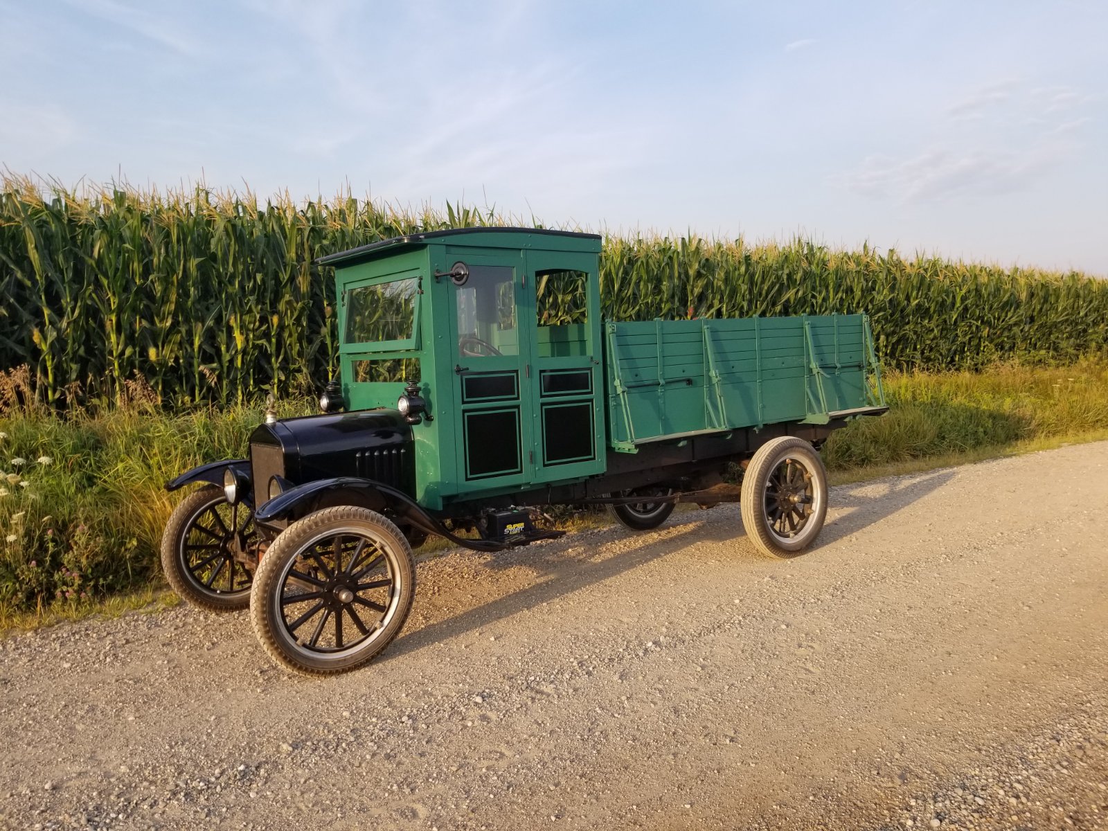

My truck has a Model AA (A truck) underdrive unit (which is made by Ruckstell by the way) installed 180 degrees around so it works as an over drive. I can get 45 plus down hill with a tail wind BUT after that experience my hair went white......
Probably 30 to 35 is the optimal cruising speed for an auxiliary gearbox equipped TT with a high ratio diff set and 17 to 20 (ish) for a standard low ratio rear set and no aux-box.
Plan ahead when it comes to stopping!
If you have an aux-box installed BEWARE - you probably have a neutral with it which means NO BRAKES if you get stuck in neutral UNLESS you fit auxiliary external brakes like Rocky Mountains or a disc brake set. Not a bad idea in today's traffic anyway, but it does highlight the 'knock on' effect of one change requiring further upgrades for safety.
BUY A TRUCK DRIVE A TRUICK HAVE FUN! ;-)
