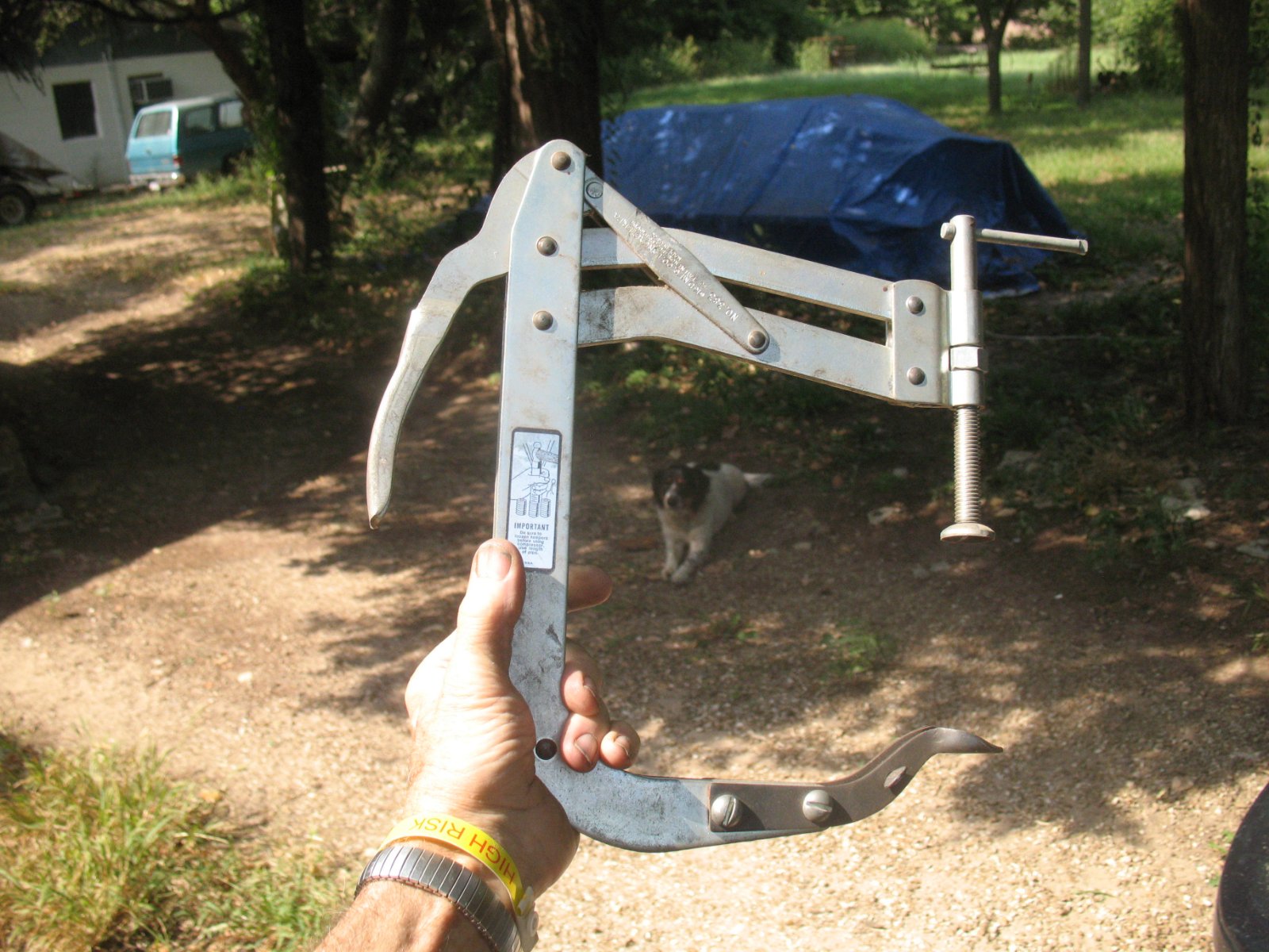

Anybody got a homemade valve spring compressor that works well on Ts? 'Specially one that will work on an engine with the manifolds still on. Let' see it, please.
Or, recommend a good "store bought" one. I've had an old one for years that , as it turns out, is obviously not for a Model T.

I bought this fancy one for $2 at a yard sale.
Here's one I cobbled together from scraps on hand.

The big factor-
can you do it with the manifolds still on?
A vaporizer would really test a man's patience! OUCH

I looked again and found "my other" valve spring compressor that will work on a T, then went to the local flea market and bought a Sunnen brand one that works even better, for $3.00.
