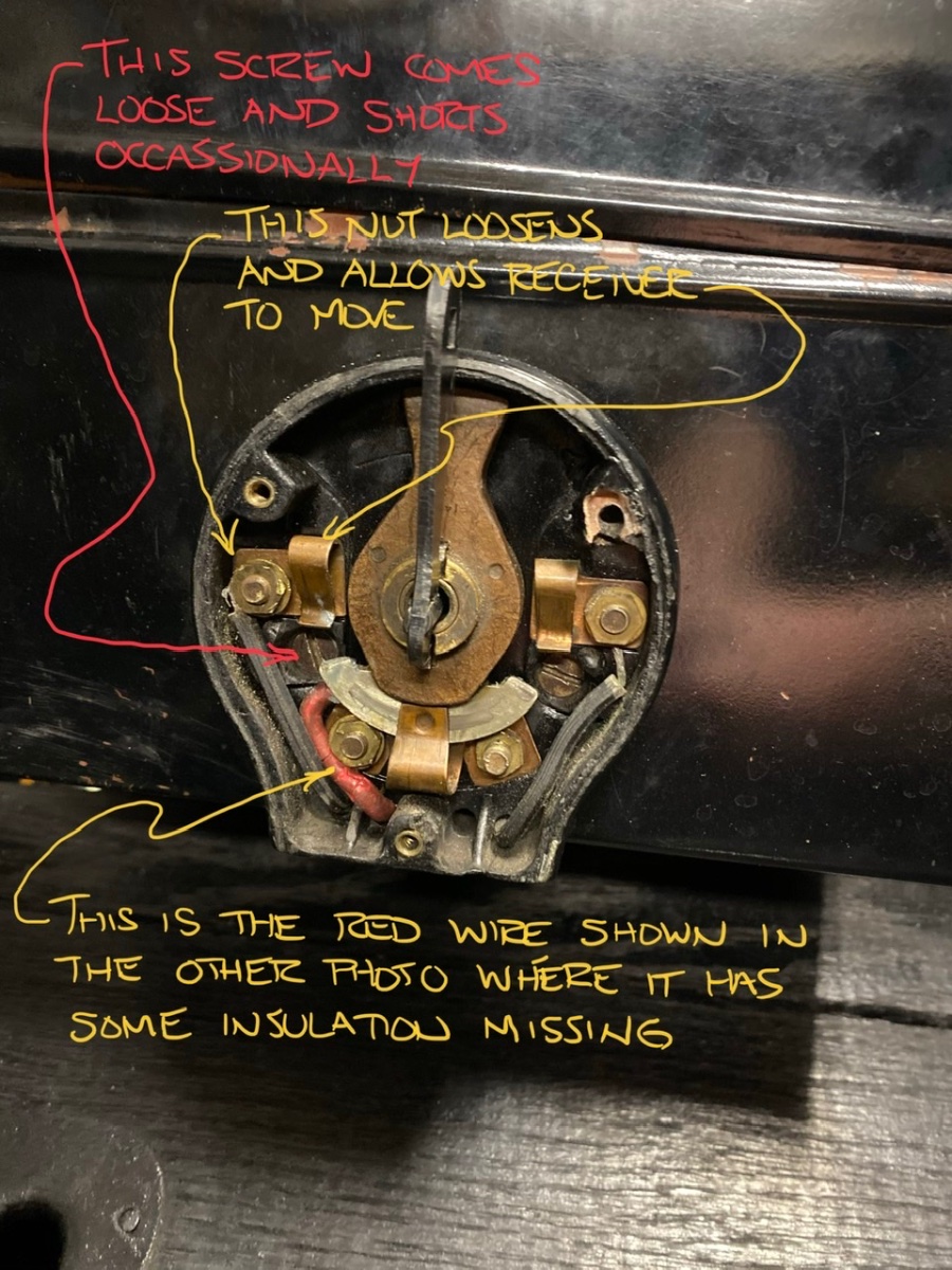

One bright spot is that I’m not getting zapped by anything (and the headlights are still working).
Here is my ignition switch box and a couple notes:
If there was a short in that red wire (in the bottom of the box), wouldn’t I show power somewhere (like the coil box might be ‘hot’)?

The stud in between the terminals looks kinda questionable to me.
You can do a voltage drop test there, check voltage at the wire and then on the stud and terminal. Or you can wire a 12V headlight bulb and check the same way, that will put a load on it...

Steve, I’m thinking your thoughts on the ignition switch are the winner here. Looking back on that picture of the wire at the bottom of the coil box that had some of the insulation off, could this be the short?

You wouldn't get the continuous buzz on magneto because it's not turning fast enough to supply enough current. You may be hearing that continuous buzz from just one coil. That can be caused by the top timer terminal screw grounding against the timer control rod.

Thanks for the reply, Steve. I will check this afternoon after work. I checked it last night as it was one of my 'easy' checks. I just need to make sure I check it correctly this time. ha ha ha. I'm pretty sure they were buzzing even when I advanced the spark and the top terminal wasn't making contact or even close. It never hurts to recheck!
It definitely wasn't an issue of the mag because the car was off when I tested the mag (just to see if there was a short that was putting power through while the ignition was turned to mag). I did this because it sounded like the coils were buzzing while the car was up and running and driving on mag (the coils sounded like it/they would when getting ready to crank start and a coil was aligned so that one of the coils was active). If that makes sense
I'm really worried about that one wire (I mentioned previously) that runs through the bottom of the coil box that has damaged jacketing/insulation. That and your (Steve's) suggestion of damaged insulation in the ignition switch box. I'm likely going to be buying a new one as I need the car up and running for two Christmas parades this weekend. :(
