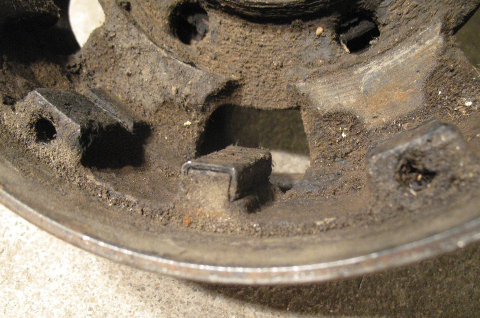

Does anybody know what is the minium thiknes a low drum can be?
This is the inside of my brake drum, I don`t find any brake drum shoes...
Bert

Bert, All the 1926-27 brake drums I have seen was machined like this for the shoes. Yours don’t look to have been machined for shoes.

Bert, are you sure you have a 1927 brake drum? I can't be sure from the pictures.
The lugs on 26-27 brake drums have steel shoes to protect them from being worn by the clutch disks.
The sides of the drum extend out past the lugs.
The 26-27 brake drum is about 1⁷⁄₈" wide (498mm). It's much wider than the low drum.

That drum had been built without the brake lugs installed. It's machined for them, but they were not installed at the last rebuild. You can see that the extra radial slop allowed by these missing lugs has allowed the discs to move around such that they have chewed up the bolt lugs, too.

Bert, Those machined in hooks for the shoes are to stop the shoes from sliding toward the flywheel. Without this catch the shoes are free to move out of place and cause a mess in the transmission. I would not put shoes on this drum without something to hold them in place.

His drum does not have the indent for the replaceable shoe to lock in.
Re: Transmission 1927 pickup questions
Posted: Thu Jan 31, 2019 6:38 pm
by Mindless Automaton
If it were mine, I'd drill a small indent in the lug and center punch a matching dimple in the shoe where the clutch exerts no force. And then lock-tight the shoes in place.
Posted: Thu Jan 31, 2019 6:43 pm
by Scott_Conger
You all are right about the lock-groove. I missed that entirely. I think this drum has a future as a band-shaping mandrel, but not as a brake drum. I know replacement in that part of the world will be an expensive proposition, but it is looking more and more like a replacement needs to be found.

I have seen one wide brake drum without shoes. It must have been a very early one. Ford even offered a narrow drum with shoes in mid 1926. They show up occasionally.

First you need to properly re-rivet the drum to the shaft.
Then you would have to set that drum up on a rotary table on a Bridgeport type milling machine with a shaper attachment and re-machine the sides of the “lugs” to be precisely the correct width and with sides that are precisely spaced 60 degrees from each other.
Then, the entire drum can be set up on a mandrel, between centers, on a lathe, and the groove for the lug retainer can be cut and the outer surface of the drum machined concentric with the inside bore of the shaft. The drum can also be faced at this time to reduce/eliminate runout of the driving plate shaft at the fourth main.
Probably about 1 days worth of work at an industrial machine shop...
Posted: Fri Feb 01, 2019 5:07 pm
by Allan
I don't think that drum has ever been machined to take the shoes. When compared with photos of the shoes in place, the lug on the drum is much closer to square than on the suspect drum. The ratio of height to width is quite different. That may also explain why there is no relief for the locating device on the lug. It means that there should be ample material left for the drum to be machined to take lugs, but at what expense? A replacement may well be the best/most economical answer.
Posted: Tue Feb 05, 2019 5:36 pm
by RajoRacer
I have a '25 brake drum w/replaceable shoes - came out of a tear-down.
Posted: Tue Feb 05, 2019 11:15 pm
by Allan
The really weird thing is the shoes were introduced in the late 25 model narrow brake drums, before being carried over to the wider drums in the 26-7 models. If this is a genuine Ford drum, it is truly an anachronism.
Posted: Wed Feb 06, 2019 12:36 am
by Scott_Conger
Allen
makes one wonder if this is possibly partly completed stock that was surplussed and found it's way to a NOS flea market table in the '70's. If that is the case, there may be other missing machined features leading to the "one washer" issue. I have seen pitman arms missing the woodruff slot and other similarly odd or incompleted parts. This may be similar.
Posted: Wed Feb 06, 2019 4:58 am
by infotfordnl
Allan, Scott,
The rivits of this drum where lose, so I think that the previos owner install this drum later.
He told me he did the restauration 30-40-50 years ago, thats comparring with the 1970 idea of a rare stock drum.
I dont see a print of ford in the drum, but T709. inside an 8 and outsite an 7
what is normal? is it an aftermarked drum in that days?
I will send another 5 pictures of this drum, if you see something what is nog comapring with normal drums, please tell me
evenso tell me where I had the grind of material to get the 2 or 3 washers and the 0.015" space
Bert
Posted: Wed Feb 06, 2019 7:11 am
by Allan
Scott, I can't see the drum being 'partly machined'. It does not make sense to machine the lugs so far and then have another go to get them to lug size. I could understand them being lug sized but missing the step for the locator. That may have been a separate operation.
I need to have a look at a couple of original 26-7 drums in the morning to see how they compare with the new photos.
Posted: Wed Feb 06, 2019 11:41 am
by Scott_Conger
in retrospect, I think I can agree with you regarding the lugs not being partially machined. My reasoning was not especially well thought out the other day.
I keep looking at the pictures and continue to ask myself, if the lugs are in FACT machined properly for width and simply not notched for the keeper-tabs. The worn lugs in the last pictures posted sure look skinny to the point that a shoe would fit. Really hard to say from a picture. I wonder if the drawings ever had an official version where there was no retaining notch in the shoes? I have little experience with later transmissions with the exception of one that is in my 1923 (yes I am aware that it doesn't belong there, but it was, and is, and performs just fine with an earlier hog's head and narrow band. I didn't bother turning the drum down as it fits the pan with a skosch to spare). That is the only wide-drum transmission I've ever rebuilt. All the others I've done were 1919 or earlier.
Posted: Wed Feb 06, 2019 12:49 pm
by DanTreace
Photo of J&M new '26-'27 large drum shows the base of the small lug for the shoes as having an end stop. But the early Ford version has no end stop, so that isn't really needed......IF and that is big IF, the small lug has full surface without any wear, so that the new shoe will fit tight, and crimp fully on the lug.
The old worn drum shows severe wear away of the small lug, IMO a shoe cannot be fit to those. A new drum is needed.
New J&M
NOS Ford with Ford NOS shoes
Posted: Wed Feb 06, 2019 1:00 pm
by Scott_Conger
Dan
I agree with your assesment that the drum is done for. My interest in lug width is mostly a "what went wrong here" rehetorical rambling. I more and more think my original belief that the lug is narrow enough for a shoe is correct and that they were simply missing on the last rebuild. Yes, I realize there is no retaining groove for the lug. I cannot account for that and may be the reason no shoes were installed. Your NOS drum is a neat artifact. That sort of stuff was common in the '70's when dad started in the hobby, but sure not so much now!
Posted: Wed Feb 06, 2019 5:56 pm
by infotfordnl
Gentleman, the origional measere of the lug is the same as the outside measure of the shoe, this drum is produced for no shoe using... with all the imput thats sure for me,
I understand that it is very rare
Maybe a not finisched serie, or a small aftermarked production... there should be more of them..
the situation now is that I will try to machine the logs so the shoes will fit, I will show you the result, but that will be over 2-3 weeks.
Tomorrow first a small holiday and days to think over
Ha thanks all for the interest in this
Bert
