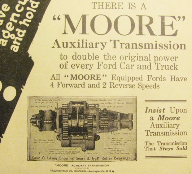

Hi All
What type of Moore do I have here and what is missing please
Cheers
Andrew
Re: Moore gearbox
Posted: Mon Dec 16, 2019 9:50 am
by DanTreace
Pinion section, shift rod and control lever.
Re: Moore gearbox
Posted: Mon Dec 16, 2019 3:49 pm
by Allan
The pinion bearing and housing are standard Ford items. You are missing the output shaft, driven gear and the selector dog.

Andrew,
I have a Moore that is missing the output shaft as well, so if you find two let me know.
Jay in Northern Ca posted a very complete discussion of the Moore transmission on May 6, 2010. Lots of pictures so you will be able to see what is missing on yours.
