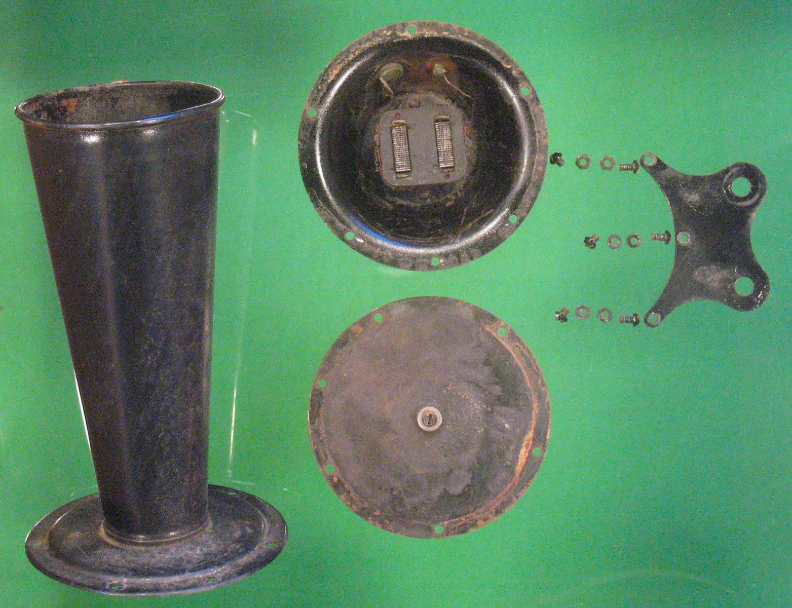

I can only send one photo at a time because it wants to reproduce them in triplicate, these are the innards of a magneto horn that I have.

I have not got this one pulled apart yet but notice the staking on the screws. They are all staked the same way with the waffle pattern even the ones holding the bracket on.

I guess they weren't meaning for anybody to take that apart...or the vibration was so great that if unstaked the nuts would back themselves off, as unlikely as that sounds to me...they usually rust in place before they vibrate off.

I don't know if the staking was factory or added later, but seems to be odd that someone would have a waffle pattern setter that was that small. Maybe someone else can chime in on whether it was or not.

That's interesting as that is the same pattern done on the brass magnet clamp screws.

Like many other Ford parts, horns were supplied by several outside manufacturers. All magneto horns can be identified by the adjusting screw in the center of the diaphragm. This is a HECO horn.
The screws are not staked.
I'm working from a laptop that doesn't have the software to remove the reflections.
Re: Magneto Horn...
Posted: Thu Dec 19, 2019 1:23 pm
by Steve Jelf
There is a single wire terminal. The other end of the coil is grounded.
The center adjusting nut is crimped into the diaphragm.

I don't think the "screw" has to beat against the coils. I believe the constantly changing direction of the AC causes the magnets constantly to reverse polarity, pushing and pulling the plate on the end of the screw and vibrating the diaphragm. I don't know if there's supposed to be a jam nut. I didn't find one in this horn.
The coils are held in by two rivets.
