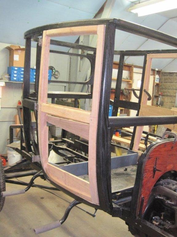

Hi all, l am at the point of bolting the body down on the 20 coupe I've been working on since 2011. It seems to me that the tank is to high for the seat, so I looked back at the pictures I took while taking it apart and it looks like that is the way it was. So wondering if there is someone out there with the oval tank under the seat in a coupe that can tell me if this is correct. Thanks George

However... According to Bruce’s book, At some point in late ‘20 some coupes did have oval tanks installed as an “experiment”. Your seat base doesn’t look right for an oval tank though.

Some of the closed car seat frames had a wooden framework below the springs. The somewhat later coupe I had did. That wooden framework allows about 3/4 inch clearance above the seat riser frame that the ends of the gasoline tank can fit in. Does your coupe have a single or split seat cushion frame?
I don't know for certain which style tank your coupe should have? Ford bounced back and forth a couple times between 1919 and 1923. The oval under seat tank is less trouble with hills, about even with filling inconvenience. If that is what it had, it could have been changed at some time in the past, or it may be correct that way.

Thanks for the replies. Wayne I have the single cushion seat, I think it has the 3/4 wood frame you mention, but I don't think that is enough. I need to get some help to get the cushions down from storage and try them. Still hoping that someone out there has one of these coupes with the oval tank. I like the idea of it being a little different than the norm.

On the later coupe that has the oval tank, it still is higher than the frame, the seat base frame is built to roll over the tank.

George, even if it is not absolutely "correct" for your car, a wooden frame under the seat cushion is common on most Australian bodied cars, so it is period correct. Looking at your 'before' photo, the tank seems higher than the seat base, so it most likely did have a wooden base to the seat assembly, and that gave it the necessary clearance.

Mark the trunk (turtle deck) was mostly nonexistant, I think the floor was there but I can't find it now, probably didn't consider it any value :cry: so my plan has been to build a wooden pickup bed I have period hardware for that. So I kind of have to keep the under seat tank. Hopefully the seat frame will allow it. Thanks for the replies, still hoping that someone will have one of these coupes with the under seat tank.
