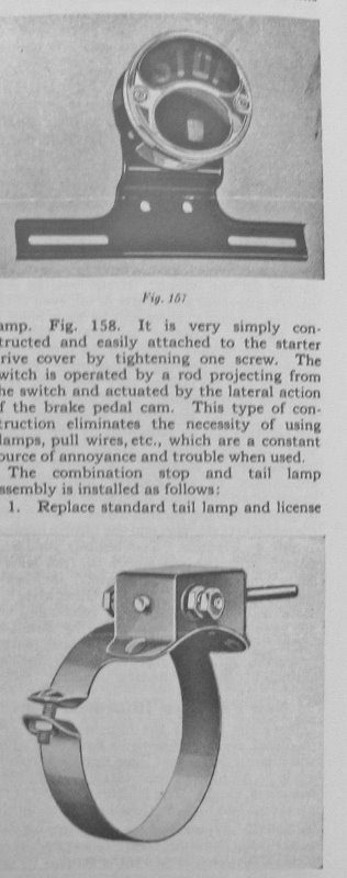

Ford offered the combo Stop Tail lamp in 1926. Came with a special switch too, placed on the Bendix cover.
Believe the wiring would have been just black, like the tail lamp wire. The short wire would be run from terminal block # 1 (yellow/black), so it would indicate on the ammeter, to the switch. The long wire would run from the switch to the stop lamp bulb, threaded in the dual socket of the new stop/tail lamp. That long wire runs along with the tail lamp wire and is taped to it in places with friction tape.

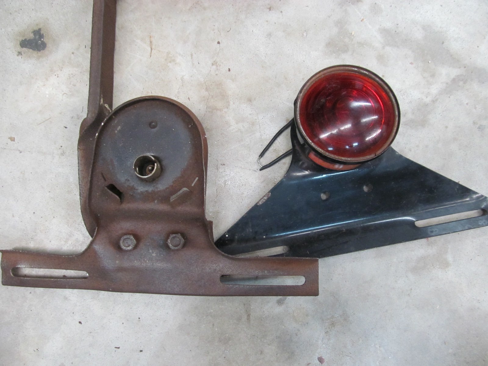

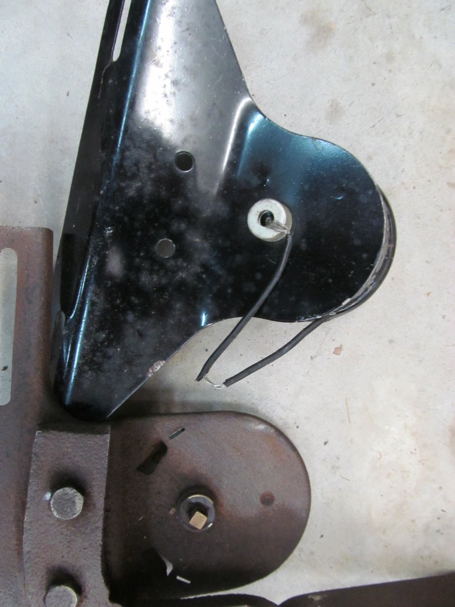

Did Ford offer a replacement license plate light after the end of production, like after 1927? I have several that appear to be genuine Ford that use a socket in the assembly similar to the headlights. With that, you can use a spring loaded socket, either double contact, or single contact. I chose to use a double contact socket on mine, with a Snyder bulb that is made for turn signals. I don't know why Don put an offset pin on one side of the bulb, but I was able to file it off. I now have what appears to be an original taillight assembly, but has a stoplight inside. I used a 26-7 stoplight switch mounted on the bendix cover, and ran a green wire to the stoplight. Works nicely. I'm using this on a 1925.

Haven't seen such lamp with bayonet socket. Parts Books don't show a tea-cup license style lamp other than single contact for tail bulb. That little socket does have same dia. as a headlamp socket. The little socket has button contact for the blunt metal tip that is stock on the late Ford lighting wire loom for the tail lamp wire.
Lots of aftermarket type to fit to the slanted Ford rear rim carrier too. All have single contact.
Would be easy IMO to change out the single contact socket with a double contact socket, for adding brake lamp, and use today's twin filament bulbs, smaller c.p. ones to fit, don't think those are period bulbs, exc. the headlamp too large c.p. bulb.
