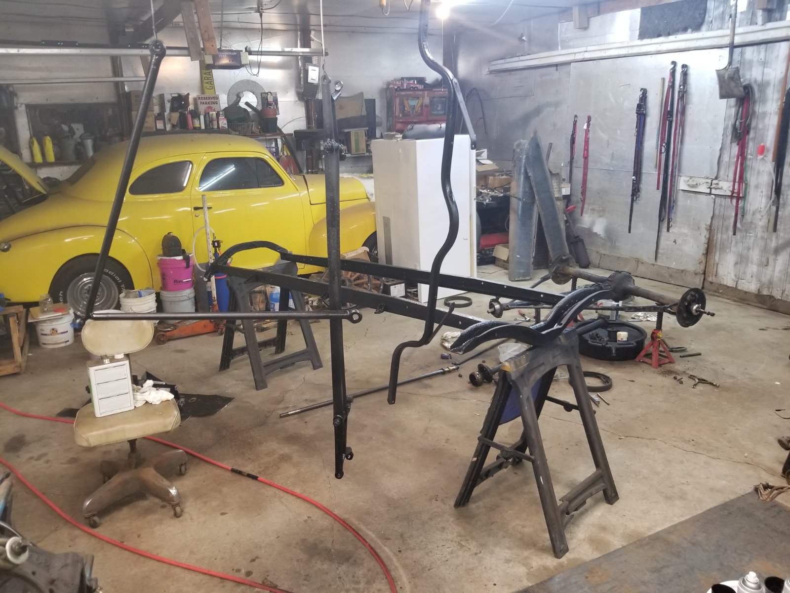

Posted: Wed Jan 29, 2020 7:32 pm
by Dallas Landers
Good day! I picked up my replacement frame from the sandblasting guy today after work.
After a little prep, I got some paint on all the raw parts I have been waiting on. All the suspension parts are rebuilt and painted.
This weekend I will be happy to start putting it together. Finally!

Re: Major surgery to ride again.
Posted: Sat Feb 01, 2020 8:03 am
by Dallas Landers
He is doing great. Cast is off now and he is running around again.
I hung the front and rear springs, front axle and spindles on the frame last night. Hope to have a roller with an engine soon!

A little update. I had sme time today to spend in therapy. I got the Muncie hooked to the reat axle and everything bolted in place. Hook the front radious rod to the pan and the drag link and the chassis will be complete. Next step is swapping things from old engine, carb , generator, ect...
I snapped this before today.

Hmmm, don't suppose you loosened the rear end all up, used a handy-man jack or some-such to push it back to gain the clearance? I did that in 15 to put a new clutch pack in. With the engine in the car. 8-)
Ehh, prob'ly not.
Looking good! :)
Posted: Thu Feb 20, 2020 6:53 am
by Dallas Landers
After looking things over, I used the Mark's method. Removed rear axle and went that route.
