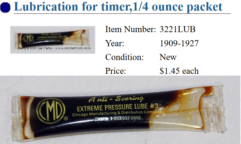

Posted: Wed Jan 01, 2020 1:54 am
by TRDxB2
Why wouldn't you use this?
Not sure which STP formula you are referring to but the original contains Zinc which is a relatively good conductor.
