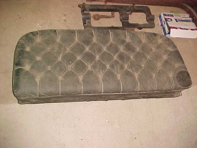

I made the patterns for my upholstery for my late 1911 Beaudette bodied touring car. In my research from original upholstery, I have determined the cushion for the Beaudette is two diamonds deep and the Hayes three diamonds deep.
Early 1911 used the wood frame seat, later in the year (on Beaudette cars at least) the frame was steel, then the bottom was covered with hardboard and artificial leather.
Here is a Beaudette Cushion:
Here is a Hayes Cushion:
Here is another Hayes cushion:
The back seat cushions are typically one diamond wider than the front cushion.

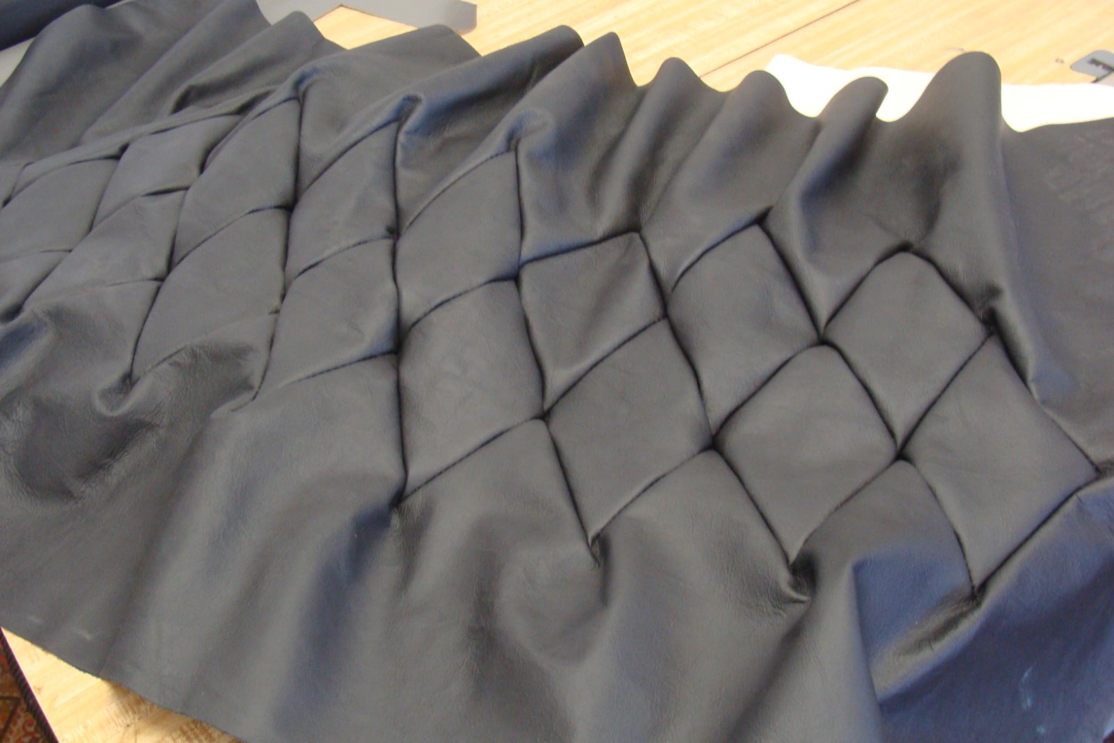

Here are some more pics from my project:

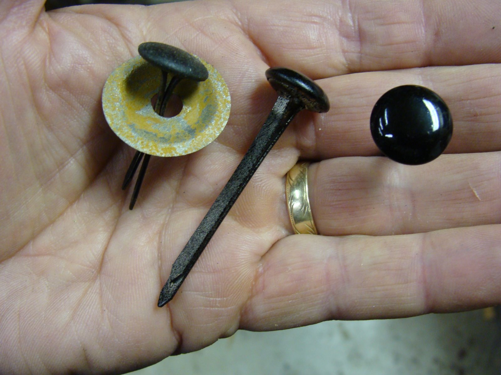

Metal covered prong type buttons. Original on left, new on the right.
These ligne 22 prong buttons came from C and C Metal Products in New Jersey. Although I only needed a couple of hundred of them, their minimum order was 5 gross! I painted them black. You may be able to get some from Michael at Classtique. He now gets them from C and C.
There are a variety of different sources for horsehair. If you need some, maybe someone will chime in.
If you are doing a super accurate and authentic restoration, I have some 3/8" capped upholstery nails available. If you are interested contact me directly.
