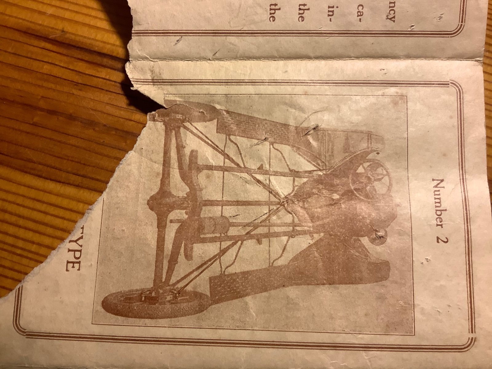

Interesting information, Tim.
Has anyone here seen a set of A-Cs that were set up to the emergency brake as shown in picture labelled #1? And it looks like set up #3 uses 1 cable attached to the emergency brakes and another cable run to the brake pedal and center mounted equalizer pulley. The number 2 set up looks like all of the cable brake installations that I’ve seen described here on the board.
