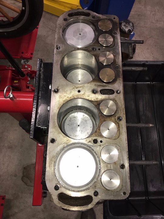

Well I got the engine out after work today!!!
When I took off the Rad Rod I found not cotter pins and different size springs. That's not good.

So now I can see two issues that I had known about . First the Mag Ring is the wrong year. That explains why my starter wouldn't come out.
Then I saw that one of the pins was broken on this triple gear. I hope that's the only issue..

Re: Getting Rattles Back On The Road
Posted: Tue Jan 14, 2020 9:26 pm
by Mopar_man
Well today I got the Pan off. here is a look inside.
https://www.youtube.com/watch?v=HpwDrVDo_No
As you can see the triple gear is jammed against the flywheel. The pan looks real clean. Some sludge in the bottom.

Then I took the head off. I saw that the guy who had the car before me added some washers to three of the head bolts. My guess is that there is some junk in the hole and instead of cleaning it he just added a washer to take up space. I got a new set of head bolts and head gasket. I'll remember to put the gasket on correctly. :roll:
This is what I found when I got the head off. I'm not sure if this hole I pointing to is supposed to be blocked by the head gasket. All the steam holes looked good.

Well tonight in VA the temperature was 65 so when I got home from work out to the garage I went. Today's work consisted of getting the blast cabinet working. I changed the nozzle out and now it works. I'm going to change the media out next. I also cleaned off the tops of the pistons and the valve seats. Like I was saying the motor was rebuilt and didn't have many miles on it. Here is the after.

Looks like you have something to start with, The bores look glazed,so it may have more miles that you think. Great time to look it all over. At least bead hone it and new rings. Check valves, adjustable lifters are nice. Make sure it has a good cam gear. I like the stock ones. They make better cams , and some people advance the stock cam 1/2 a tooth. Higher compression always helps. I installed high compression pistons in dads car and it was very noticeable along with advancing the cam. Looks totally stock. Thanks for sharing.

Thanks John. In looking at the cylinders I can still see the cross hatch scratches on some. Then again who knows. I'm just glad that it was rebuilt at some point. You sometimes never know until you open it up. Ha!!
