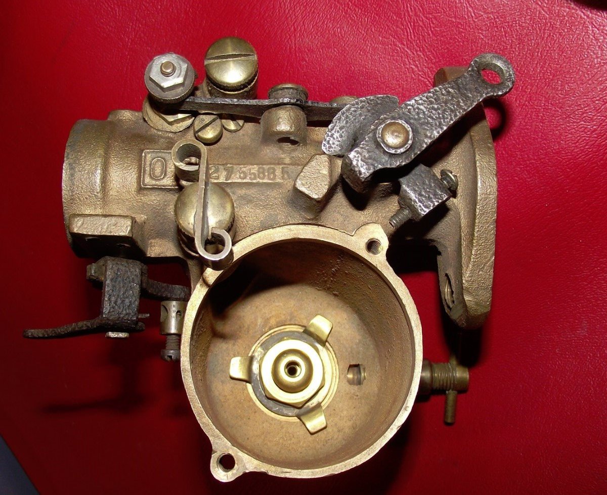

Last Saturday (12-28) Stan Howe listed a slightly modified OF for sale in the classifieds.
" notice what somebody made to fit the earlier style adjuster. I had never thought of doing that, it's a unique idea and would make it easy to adjust the high speed mixture from inside the car."
I have only ever heard one complaint about the Stromberg OF and that was from a long distance Model T driver at the Homecoming in Richmond who said "you would have to ride on the fender to adjust it".
It looks like it may be possible to modify the 26-27 swivel to turn the adjusting screw on a Stromberg mounted on a later car.
Do any of you who have these carbs think this would be a worthwhile project?
I expect to have one to play with shortly.
