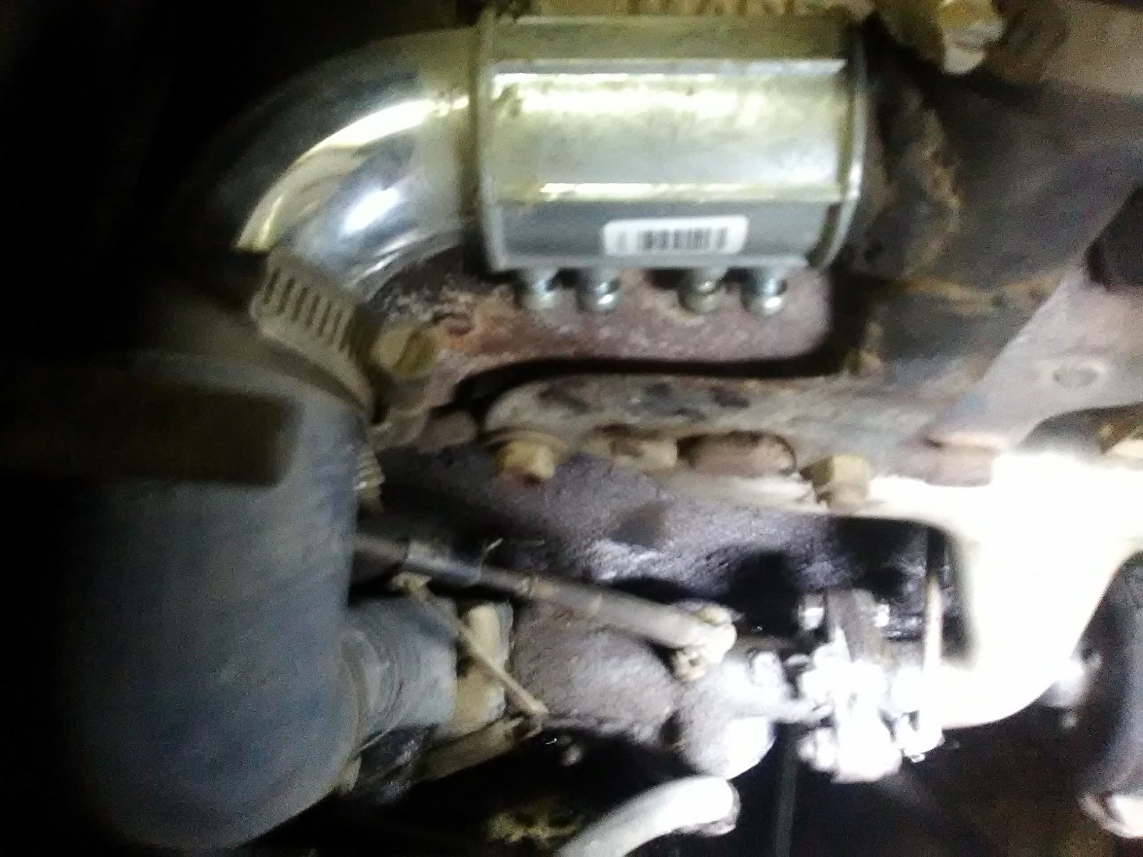

I am retired automotive mechanic and just couldn't drive a T on dirt roads without a air filter. I have 3 Ts with differing designs but all 3 work well,don't ice up and there is no change in performance. I will try to attach pictures of them.

Dennis. Your air cleaners appear to be connected, in some way, to a manifold air heater, so that you not only get the benefit of an air cleaner but also get the benefit of pre-heated intake air. My filter is about the same size as your third photo, but is not connected to a manifold intake air heater. Did you design and fabricate your air cleaners or did you purchase them? I can see where these would work. Thank you. Jim Patrick

Jim, I did fab them myself and the first one ts over the exhaust manifold and runs along the manifold giving it time to heat the air. I used a Model A air maze and the over sized filter element, a conduit connector a sink drain pipe and a radiator hose with the right bends in it. I built this over 10 years ago and haven't had any problems with it, I am always amazed at how much dirt the filter catches. The last picture is the air filter on my Funster (built for fun not speed) and I don't run it very hard and only when it is warm, the filter might not be big enough if I worked it like my other cars. It has no preheat but I am running the carb side draft and the intake is above the exhaust manifolds (it has split manifolds and duel exhaust
