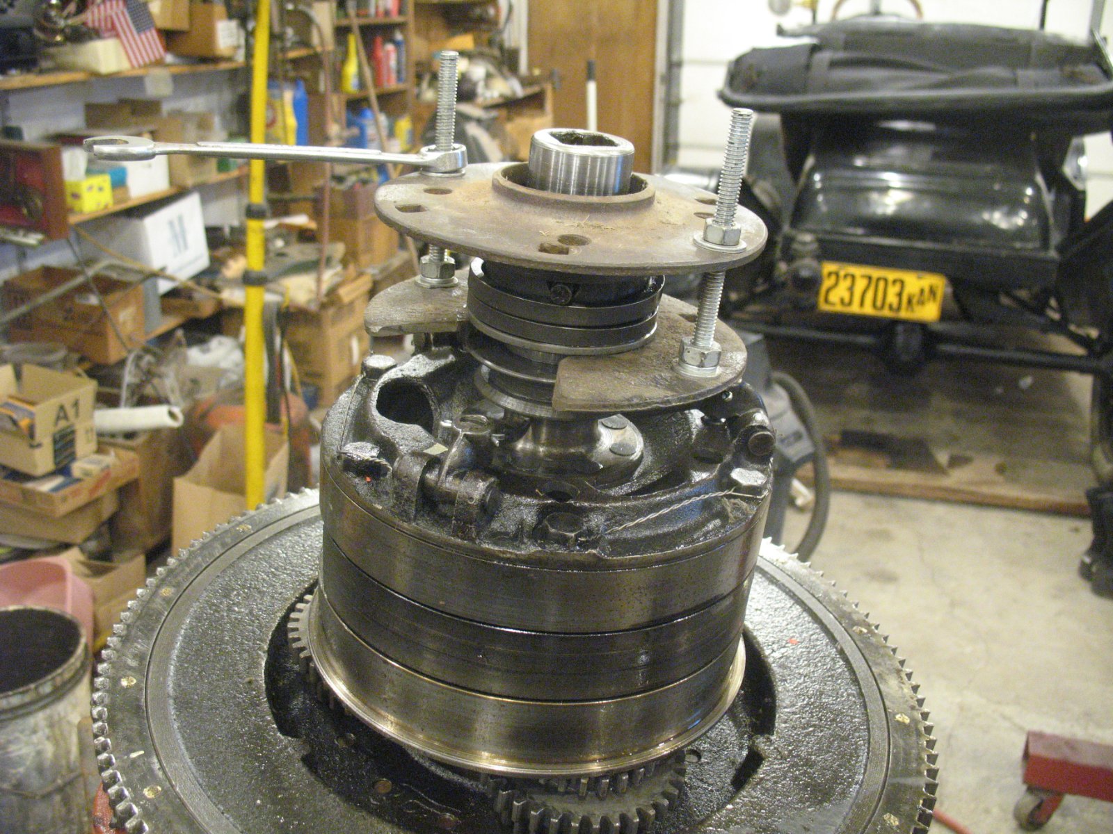

Today I continued the dismantlement.
The old hub plate tool is still handy.
Sometimes you're lucky and things line up just right.
Fishing out the clutch disks was easy enough.
The Ford clutch puller was adequate for the job this time.
Raising the transmission off the main shaft took some persuasion.

by Stu Tomlinson
This January 2020 I took up the connecting rod bearings on a 1911 Touring. As you know the miserable number 4 bearing on a 3 dip pan is always a bear. For some reason this is one went very well. I removed one shim (0.002"), but the remaining shim pack was still thick. These shims would not stay in place with grease as I attempted to replace the cap in the 3 O'clock position as viewed from the front. I finally held the shims in place with dental floss that I had hammered out to less than 0.005" inch. The caps went right on, the shims stayed in place and the bearing fit was excellent. Have a look at the right side of the photo and you will see the dental floss holding the shim pack, and all the rags of course, which totaled 7, are to keep anything falling into the transmission. The older I get, the more I enjoy a 4 dip pan.
Stu Tomlinson
