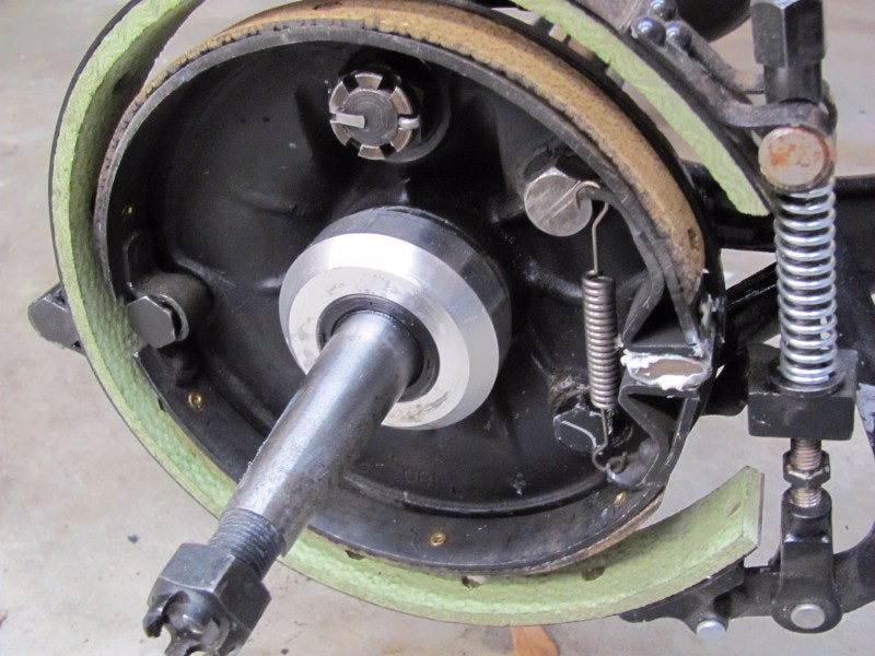

Pierre-Yves
Larry does make these small drum brakes, you order from him and likely he can help ship export to you, obviously more easily bought in the USA.
And another makes the rods and equalizer assembly, bolt on, without drilling frame. I have this set of attachments and they are well made too.
You will need a modified brake pedal or buy the accessory pedal from Larry too.
My set of Larry's A-C reproduction brakes, the emergency brake shoe is old accessory one-piece steel with new lining.

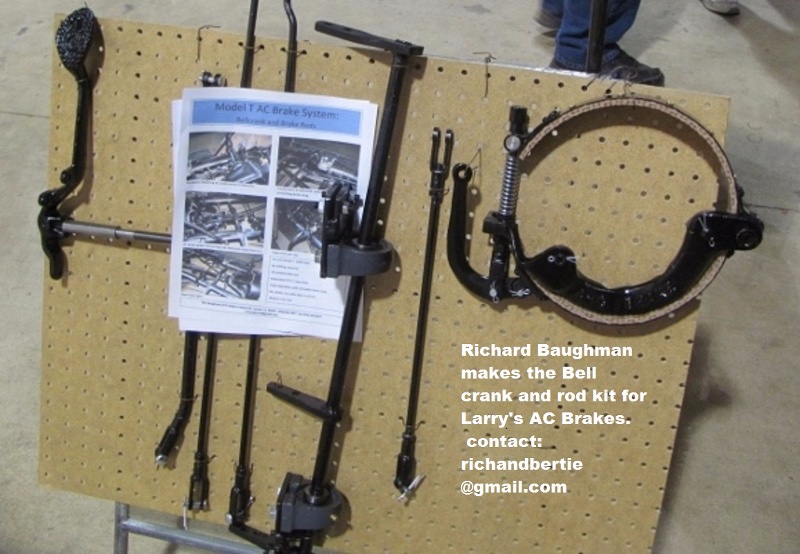

Richard Baughman makes the linkages for AC brakes.

Thanks for the information about the AC brakes. I would like to know if Mr Sidmore brakes work only work with Mr. Baughman rods assembly or can also work with cables as i saw on this 1920 advertisement. Do Mr Sidmore have a email adress? i'm not as confident in english by phone as i am by mail.

If you google MTFCA: AC brakes I think you will find previous posts describing how to set them up with a cable linkage.
If you don't find an email address for Larry Sidmore you could send him a letter with your questions and invite him to reply by email.
